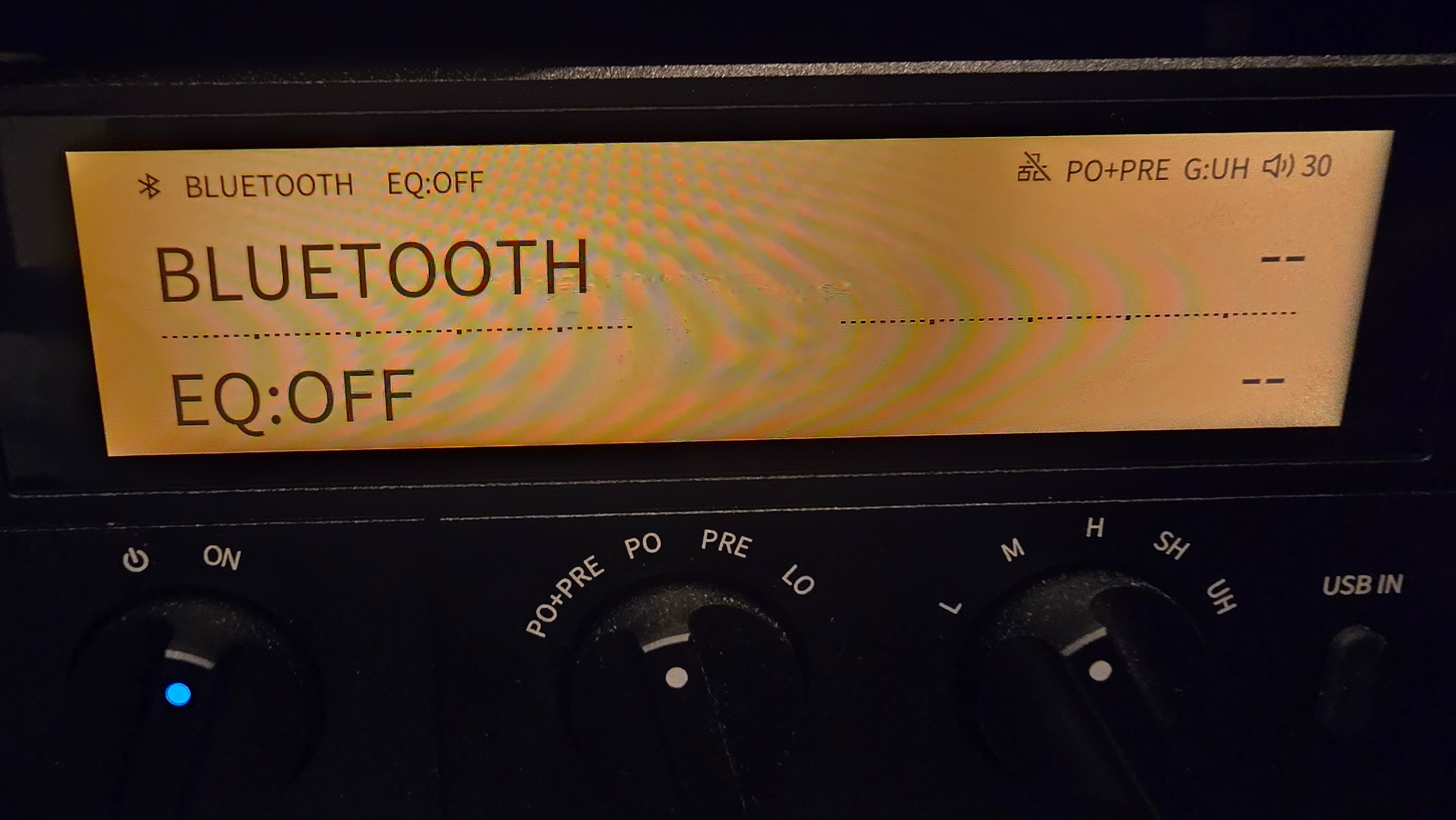

:x:BT pairing NOT working again.
I did a "Reset All" after doing the firmware update. Went to Bluetooth working mode - it doesn't go to pairing mode. Tried "Reset BT" - still didn't go to pairing mode.
BUT Then I noticed my unit is again frozen in PO+PRE and UH!
@FiiO @FiiO-Yellow @FiiO Willson
FIX THIS!
The same freezing and wifi password issues (already previously reported) were NOT addressed.
