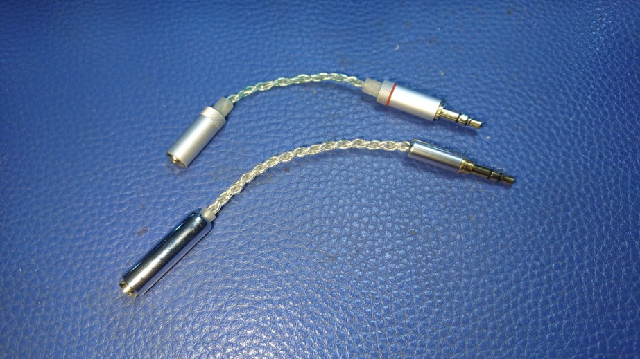

Another quick project: I have been using FiiO 2.5mm balanced female to 3.5mm single-ended male adapter for awhile now and the wires are slowly turning green. I know it won't affect the SQ but I am a little OCD that way so i thought it is the perfect excuse to make my own adapter - especially since I have a few inches of wires left from previous balanced cable project that is simply too short for anything else.
FiiO adapter cable on the top. Mine on the bottom.

Mar 6, 2019 at 3:02 PM Post #19 of 168

Mar 6, 2019 at 5:41 PM Post #20 of 168
dumb question of the day, why use straight plugs on LODs?
Err... it is not a L(ine) O(ut) D(ock)s? This adapter converts my balanced headphone with 2.5mm TRRS plug back to normal 3.5mm TRS single-ended configuration - I don't really have a strong preference for straight or right-angled plug, as long as it is small - and DIY / solder-able right-angled plug usually are not small.
