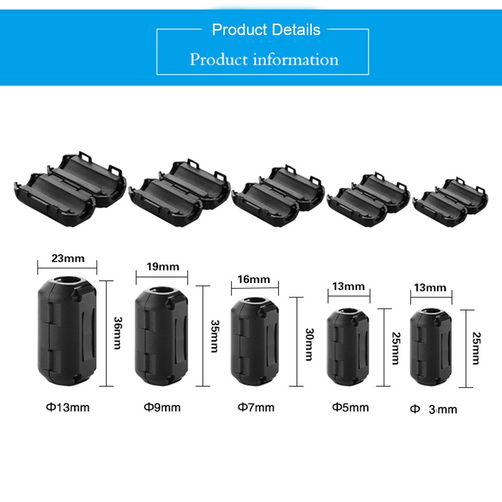

This interference I get with my mojo and iPhone is a real buzz kill. I shouldn't have to put my phone in airplane mode when I'm on the go. :triportsad:
Please try adding these ferrite beads to your usb cable. Several have reported that it helps with EMI noise.
These are very cheap on ebay/amazon.
I use the ferrite choke for my coaxial cable. I don't know how to describe the sound but I like it :)
Do you have the amazon link for this one pictured ?
Mar 2, 2018 at 4:38 AM Post #35,514 of 42,765
Here you go. Check your cable's diameter before ordering.
https://www.amazon.com/Topnisus-Ant...519983378&sr=8-19&keywords=ferrite+beads&th=1
