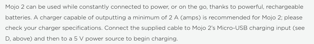

if you have a good power source, modern one, thats rated for 'fast charge' output 18w and 3amps.
Mojo2, fully charged, turn it on, only takes a moment, before you hear an internal click and it goes into intelligent desktop mode.
You should not really use a basic, cellphone brick to charge the mojo2, with its 5v 2.4amp output.
The click is the output relay, and nothing to do with intelligent desktop mode.
The charge indicator (and menu button if powered off) turn purple when the battery's full and the device enters intelligent desktop mode.
The menu button colour can also indicate the charging rate and if the charger isn't supplying sufficient current; Chord recommend a 2A charger.
Below are taken from the manual:
