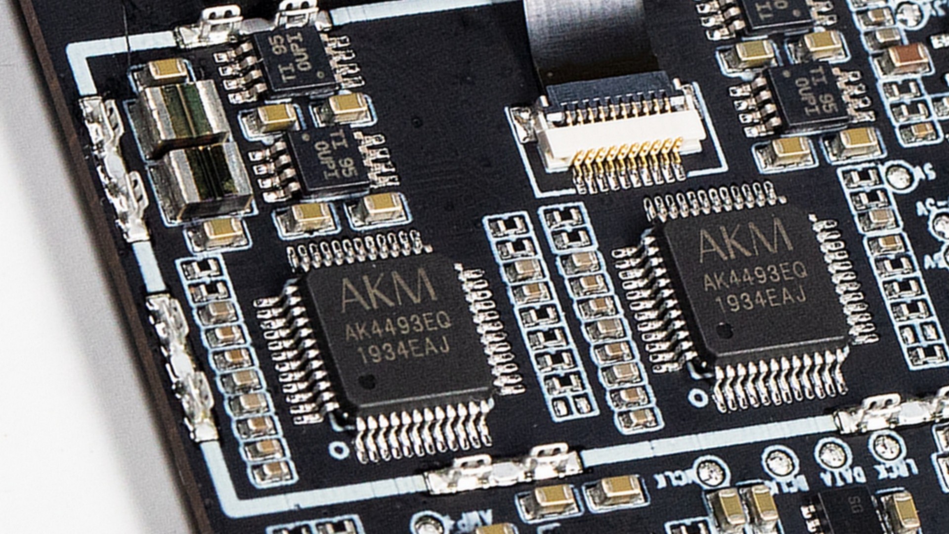

Dual DAC: AK4493 x2
N3Pro is designed around the latest 32Bit DAC chipset AK4493EQ from AKM. The player can natively decode up to DSD256 and 32 Bit/384kHz and can playback all popular file format including direct handling of SACD-ISO disc image. It is very convenient to see the ISO file break down into track right in front of you.
To implement the fully-balanced design all the way through, N3Pro has incorporates two AK4493EQ instead of on3. Each DAC chipset is operated in Mono mode taking care of one stereo channel. The DAC will deliver better dynamic range, signal to noise ratio and channel separation in mono mode.
