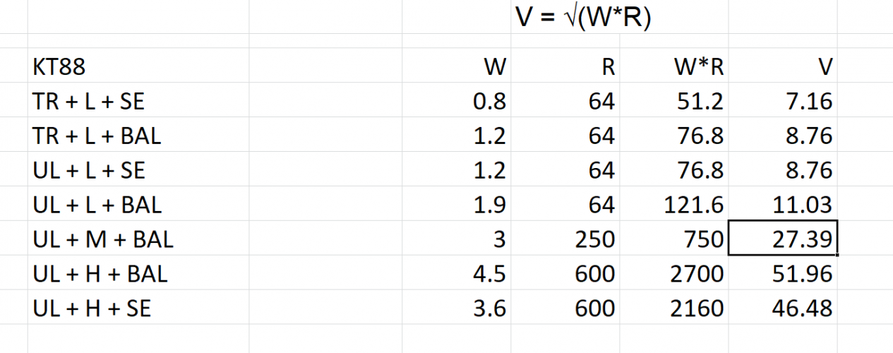

The Diana v2 is rated at 91dB sensitivity, and if you driving it with KT88, Ultralinear, Mid Impedance, BAL, the output of HA-6A in this condition is 27.39V.
The Verite is rated at 99dB sensitivity, and if you driving it with KT88, Ultralinear, High Impedance, BAL, the output of HA-6A in this condition is 51.96V.
In other word, you are using a headphone that is 8dB more sensitive, with 1.9x more powerful amplification. That explained why can't hear any noise with Diana v2, but you can hear it with Verite. Even with single-ended 6.35mm, the output (46.48V) is significantly more powerful than Mid impedance significantly.
To solve the problem, you need to eliminate or minimise the interference which is the source of the noise. It can be wireless devices in the same room, or dirty switching power supply or heavy duty appliance in the same power supply circuit (same circuit breaker), unshielded interconnect, ...
For the record, I have used HD800 with HA-6A in many shows and public demo, it doesn't have noticeable noise, and the HD800 is very similar to Verite in both impedance and sensitivity.
