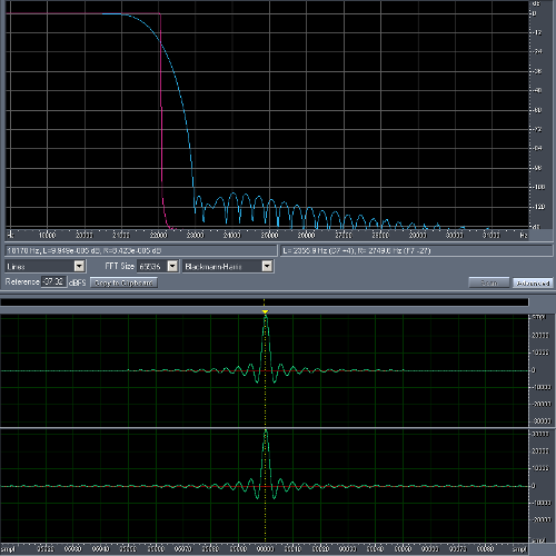

It is not that short, though, it still goes from less than 0.01 dB attenuation at 20500 Hz to more than 112 dB at 23000 Hz, but it is intentionally not like what I used for downsampling (as shown on the right channel below) so that it is more similar to real DAC filters, and is a reasonable compromise between flat response in the passband, stopband attenuation, and short ringing.
