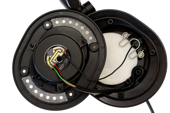

Try opening up the headphones. First remove the ear pads by pulling them off. Then remove the outer screws with a screwdriver.
The inside should look like this:
( From: http://www.head-fi.org/forum/thread/484744/crosstalk-on-audio-technica-m50 )
Let us know what yours looks like. It might be something that's easy to fix. Maybe you can find a fellow head-fi'er in your area who can help? But DIY is fun, so now would be the perfect time to start :)

I opened it up and found that it looked almost exactly like the picture posted above.  I don't have as good a camera as the person who took that photo, but here you can see there is nothing severely out of place.  I checked the connections, and each of the 5 connections are intact.
Further, the black rubber cable still has some slack, which indicates that when the cable was yanked, it probably didn't actually yank off the soldered contacts.  Rather, the tension from the yank probably went to the loop down below.
Is it possible that the wire inside/near the loop was disconnected when I yanked it?  Is that possible?

Good news is your M50 drivers should be fine. As for the cable, it doesn't seem likely that the inner wires would break while leaving the outer sleeve intact. But it's not impossible, I guess.
Try checking the plug end of the cable for anything unusual. That's usually the first point of failure for most headphones, in my experience. A multimeter would be great for diagnosing what the problem is. You can test for electrical continuity between each of the inner wires in the headphone and the plug.
Most likely you will either need to replace the entire cable, or at least solder on a new plug. I'd help you with it but I don't think the shipping costs to and from Canada would be worth it.
