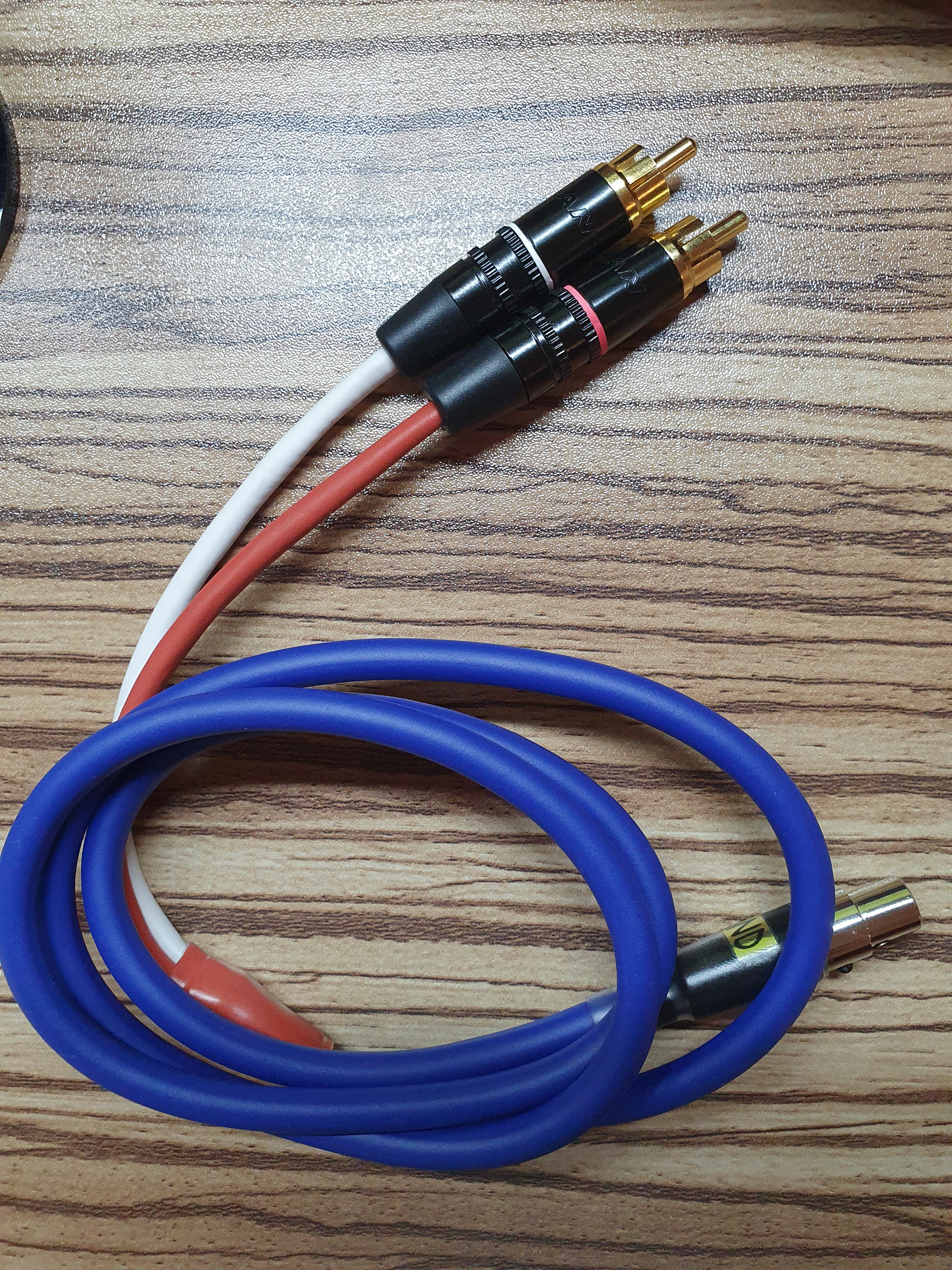

Hi folks! I have a question. I recently bought a 5-pin mini XLR to dual RCA cable to plug the Cube into my amplifier. However, sound only comes out of the red RCA and not the other. I have exchanged the cable for a new one and this problem persists. Wonder if my Kann has a faulty mini XLR port or did I fail to make proper configurations in the setting?
Are there 6 wires coming out?
Are you sure your poweramp isn't the issue?

Tried my amp with other DAC and works fine. May I ask what you meant by "6 wires coming out"?
On the one my cable guy did up for me, he has is so that the sleeving up to the 5pin connector is clear.
There should be 6 wires seen. 5pins + a ground wire. These 6 wires then split off to 2 x 3pin xlrs

This is my cable. I am suspecting because 5-pin mini XLR is a balance output, the dual RCA will not work?
Yeah, I'm not sure.
It's possible it was wired incorrectly.
No idea how 6 wires would be made into 4.
4pin XLR I can kinda understand but not 5pin with ground.
Didn't think someone would be using this SE.
Mar 29, 2020 at 3:45 PM Post #1,485 of 2,255
You can just take the GND and the Positive side of the signal to make a single ended output. It only uses half the DAC and buffer.
You can't do that with balanced headphone outputs, as they usually lack ground (4-pin, L+/L- & R+/R-).
