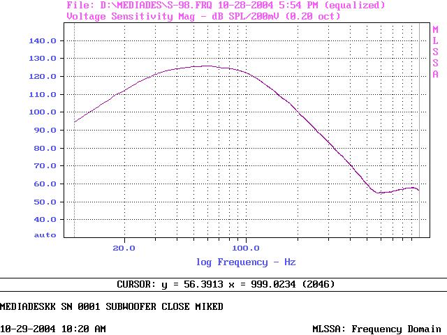

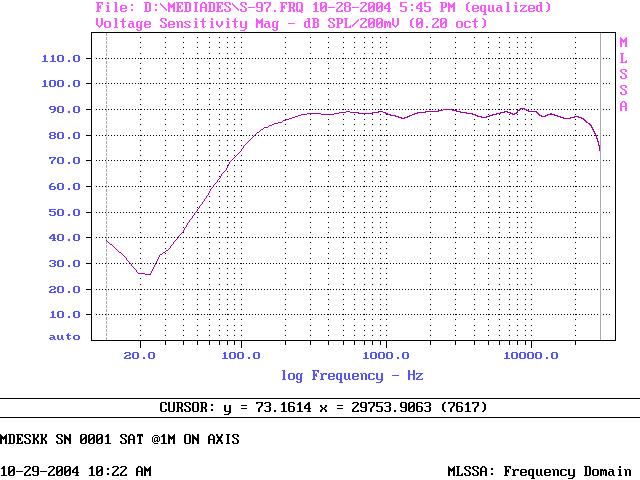

I e-mailed Blue Sky about their supposedly inferior specs and I got this reply:
Hello:
I read the post:
Here are my comments:
1) The amplifier for the subwoofer is conservatively rated at 65 Watts and we feel this is more than enough power for the near field application it is designed for.
2) The crossover point for the subwoofer is designed to sum properly with the MediaDesk SAT. The crossover is slightly higher than our typical 80Hz, but again in a near field application we have found this not to be an issue.
3) With regard to the frequency response spec: The person who posted that comment is not fully understanding the specification correctly. The manual states the following:
+/- 2.5dB 300 to 10 kHz
+/- 3.0dB 110 to 20 kHz
Note that the overall frequency response is 110 to 20kHz, +/-3dB. However across a majority of the passband (300 to 10kHz), the frequency response is smoother @ +/- 2.5dB. In general the response is extremely smooth both on and off axis.
Here is some actual measurement data:
MediaDesk SAT
MediaDesk SUB
I hope this helps.

Jan 22, 2008 at 4:25 AM Post #71 of 172
MediaDesk SAT
MediaDesk SUB
I did see the other measurement, but didn't think that 0.5 dB was a significant improvement, especially when that range didn't include the majority of fundamental frequencies (i.e. under 300 Hz).
It's up to you to do the research about low power ratings, high crossovers, and poor extension. But ultimately, the choice is yours. For $600, it's not difficult to find a pair of active monitors that have more power, flatter frequency response, and bass extension without the aid of a subwoofer (ex. Event TR8 XL, Mackie MR8).
