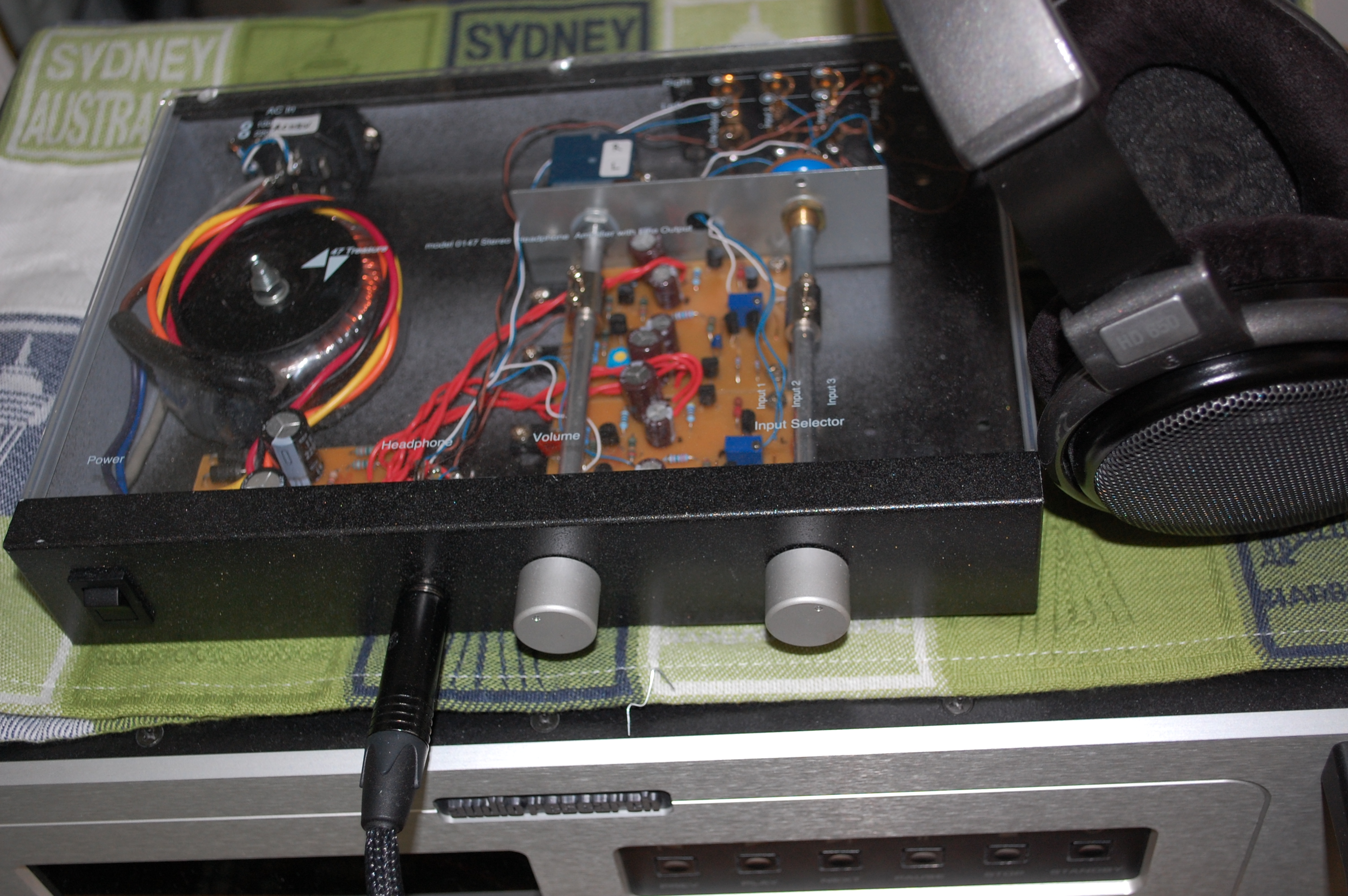

It's difficult to say because the translation is mostly gibberish and they don't provide measurements (noise, thd, etc) but I wouldn't spend 600$ of hard earned cash on that.
From what I understand, it has a gain stage which seems to be a discrete jfet opamp. This is followed by an open-loop buffer. Probably push-pull as they mention complementary transistors. Power supply is minimal, just some caps, no regulation. I see no opamps so there's probably no servo nor offset protection at the output.
If you wanted a discrete amplifier following the overall same philosophy (no global negative feedback, discrete output buffer), I'd rather have a look at the CKIII on amb's website. It fixes the main problem of the 47labs design (power supply, offset zeroing) and will probably cost you a fair bit less (even including case, etc..).
