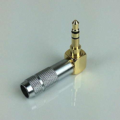

Can anyone comment if the Neutrik NTP3RC right-angle plug works with cell-phone cases? The plug itself looks a bit short to me.
This one might work as it appears there is little extension of the plug housing. Unfortunately it's ugly, but judicious use of heat shrink might solve that issue.
Different one to think about
And another one. Similar to the top one, but possibly less ugly.
Oh, one more!
Jul 5, 2017 at 3:41 PM Post #7,189 of 10,535
Thanks for the links. I saw that style, just wish that sleeve was shined up a bit more or something. It looks cheap.
I actually just discovered the Momentum-style as well (kinda pricey though). I might go with that. I just wish Markertek had some other options, their free shipping is awesome.
I suppose I have plenty of options, I'm just being picky.

I updated my prior post. Check out the last entry. It might be consider pretty by some.
Jul 5, 2017 at 4:08 PM Post #7,191 of 10,535
The last one looks a little too formal to me, the black and gold one above it might work. I'm planning on sleeving the cable with some black/blue paracord. All the black ones I'm finding have "Pailiccs" on them and it looks cheesy to me.
If you intent to use it with paracord, make sure you check the dimension of the jack. The hole should be big enough for the cable with paracord to go through so that when completed, your cable will look more near rather than making a visible heatshrink on the outside.
Look at it, the momentum style may not be ideal in that case
