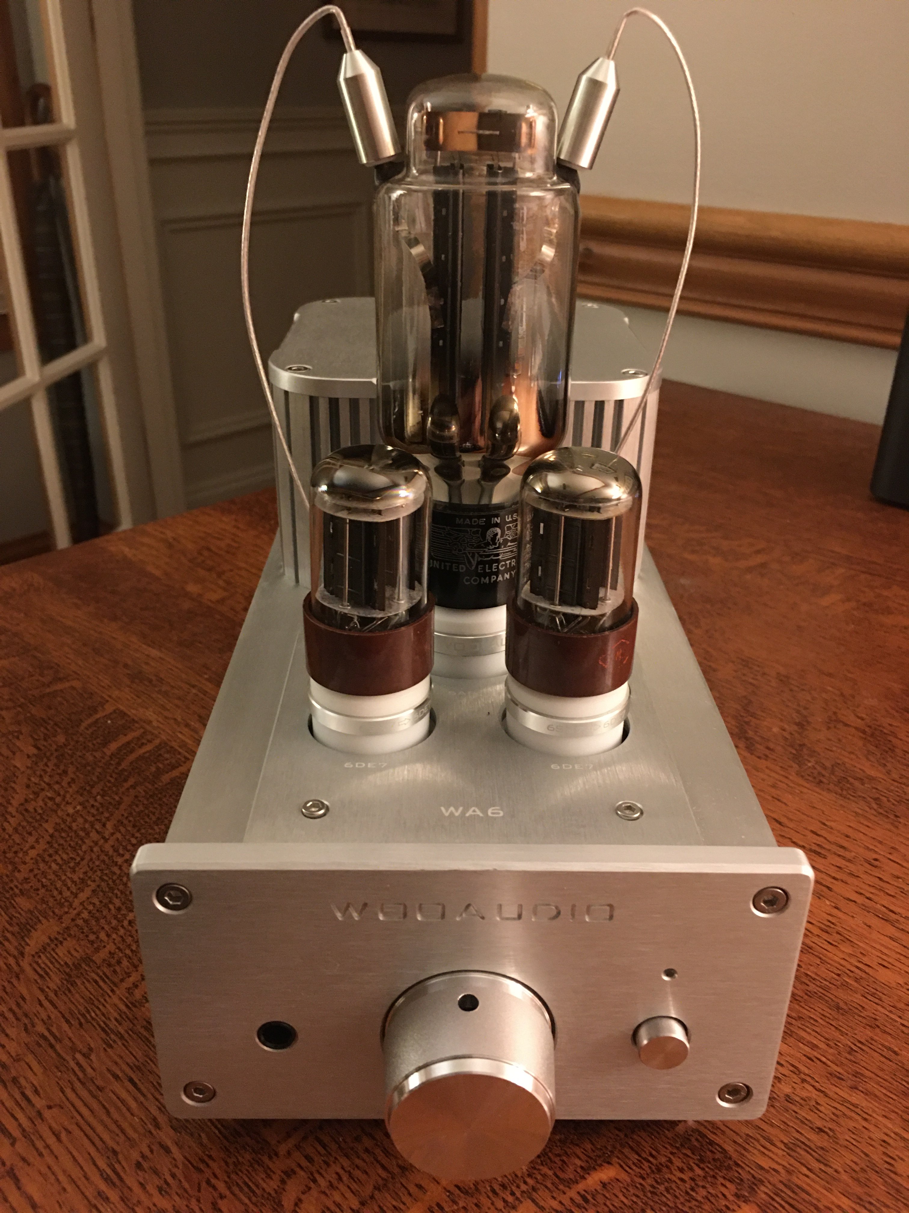

Agreed! I tried the rest, went for the best….Woo adapters are 👍👍….modeled by ‘Sixilla’ on my desk runway….
May 24, 2022 at 10:19 AM Post #1,727 of 2,694
Agreed! I tried the rest, went for the best….Woo adapters are 👍👍….modeled by ‘Sixilla’ on my desk runway….9A69BEE7-91CA-4322-9619-FECB721D43B5.jpeg
Obligatory one-upsmanship photo. But their adapters are the only ones I buy. Just got a set of 7N7's that came with other adapters. They felt like junk, so ordered them from Woo. Built like a tank, work like a charm!
