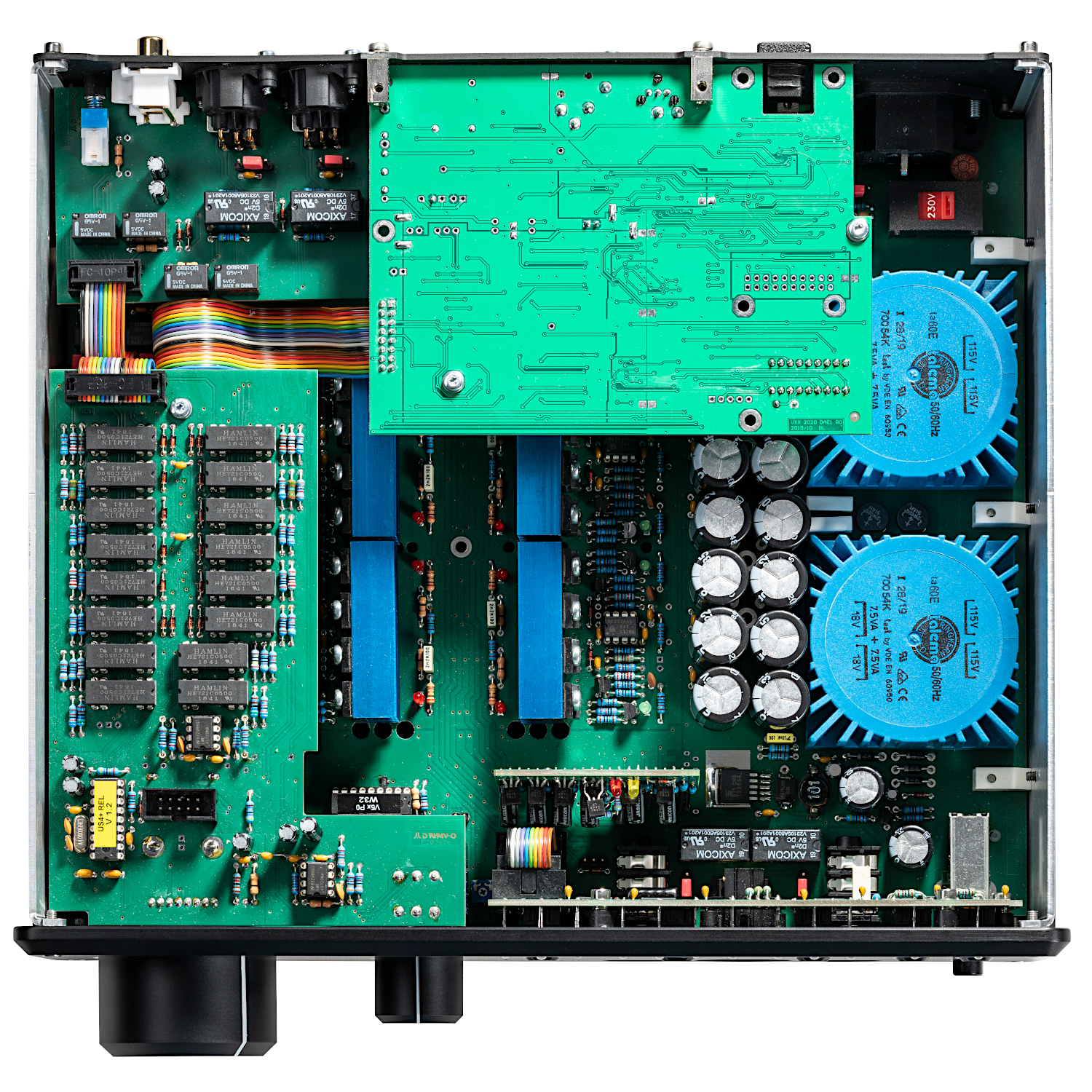

The Violectric DHA V590 DAC/AMP starts the new generation for Violectric and introduces a new form factor that is much bigger than the previous generation.
Every big device will be featuring this case or dimensions, meaning the V280 and V281 successors will also come in the same shape as we can see here, of course with different front panels as nobody likes to press buttons that do nothing, except a few DJs. In the same vein of course later DACs and various digital and analogue devices.
There will be a smaller version of this case featuring entry models of the new Violectric line. The RS series for instance (as far as I know) will reappear in the new shape, now under the Violectric brand. Generally the lineup will be much bigger and more diverse.
Anyway, the V590 is a fully fledged DAC/AMP, no part of it is an addon or a "bonus". The pictures I have here are of a prototype.
There will be small changes on the real thing. A dedicated Mute LED as can be seen on the V281 front - will be introduced. There will also be some other changes to the front panel. The glossy outlines for the push buttons (except the power switch ) will disappear.

Let's take a look at some pictures:
DIMENSIONS
(WxHxD) 290mmx80mm (90 with feet)x250 mm
Front 8 mm Aluminium sanded, brushed, black anodized, knobs with a with plastic inlay
case up to 12 mm strong aluminium, brushed and anodized
