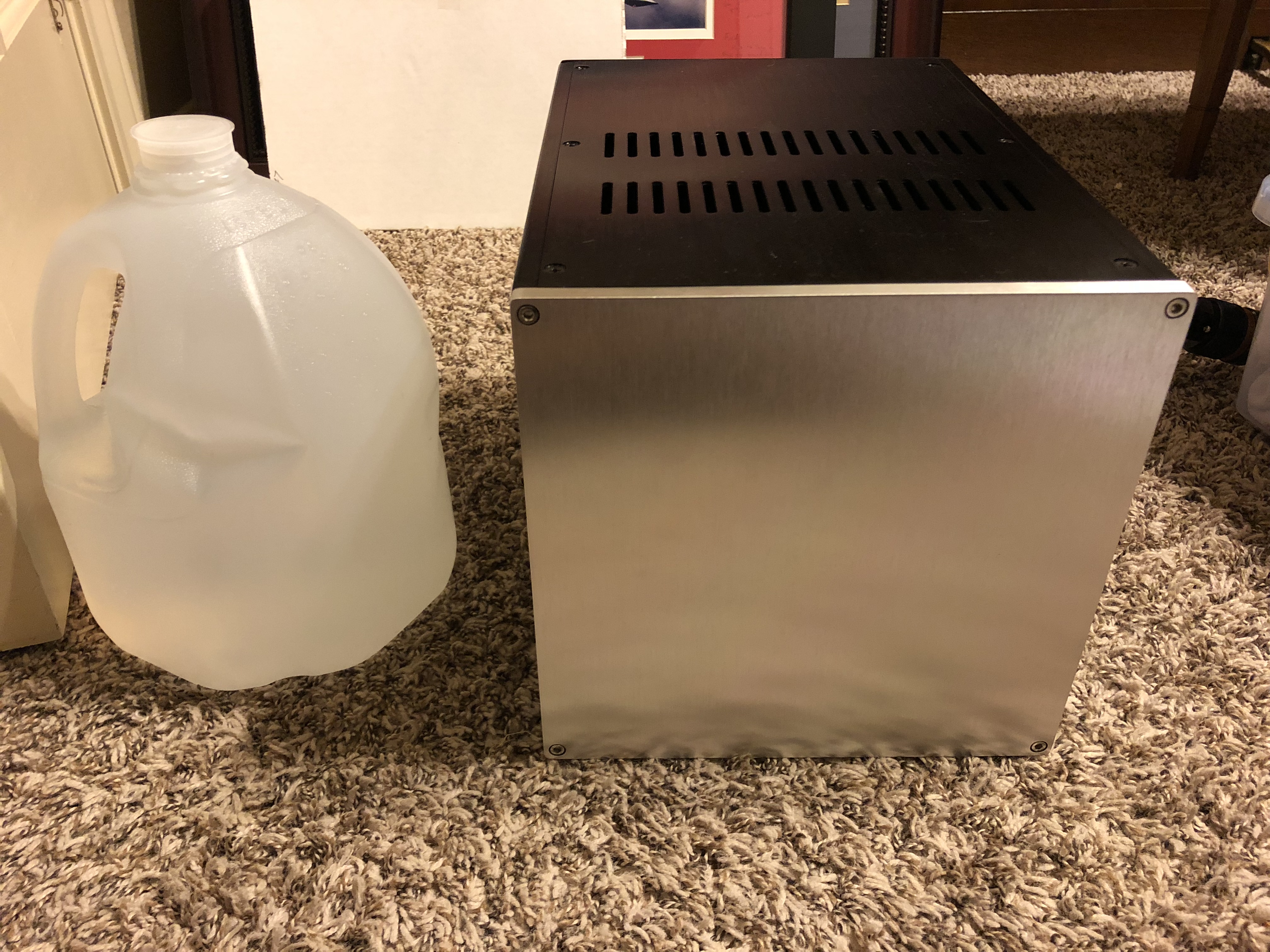

I still have the Adams and originally this was supposed to be for that system and I was going to make a second one with a 500va isolation transformer (IT) for my headphone system. Well as it turns out the topaz transformer I had was a 125va not a 500 va so it’s useless to use with any more than 1 or 2 items. I’m going to use some more of the 10 awg and put plug ends on the 125va one and see if I can figure out a use for it while I seek out a good deal on a 500 or 750va IT.
Here’s the shell for the next one:

I just did about 15 minutes of listening on it and I’d say it’s a subtle but noticeable difference across the board. About a 5% improvement 95% of the time and the other 5% I need to do more in-depth listening to evaluate. Not bad considering the money spent and I’m well in the realm of diminishing returns.

Well it’s finally done (except waiting on fuse to come in). I managed to squeeze a 1kva unit in there but cutting the feet a little narrower. As you can see thought the fit is still snug in the length direction as well.
Very nice. Did you ever happen to find any information on the white metal sheet from the other one?
