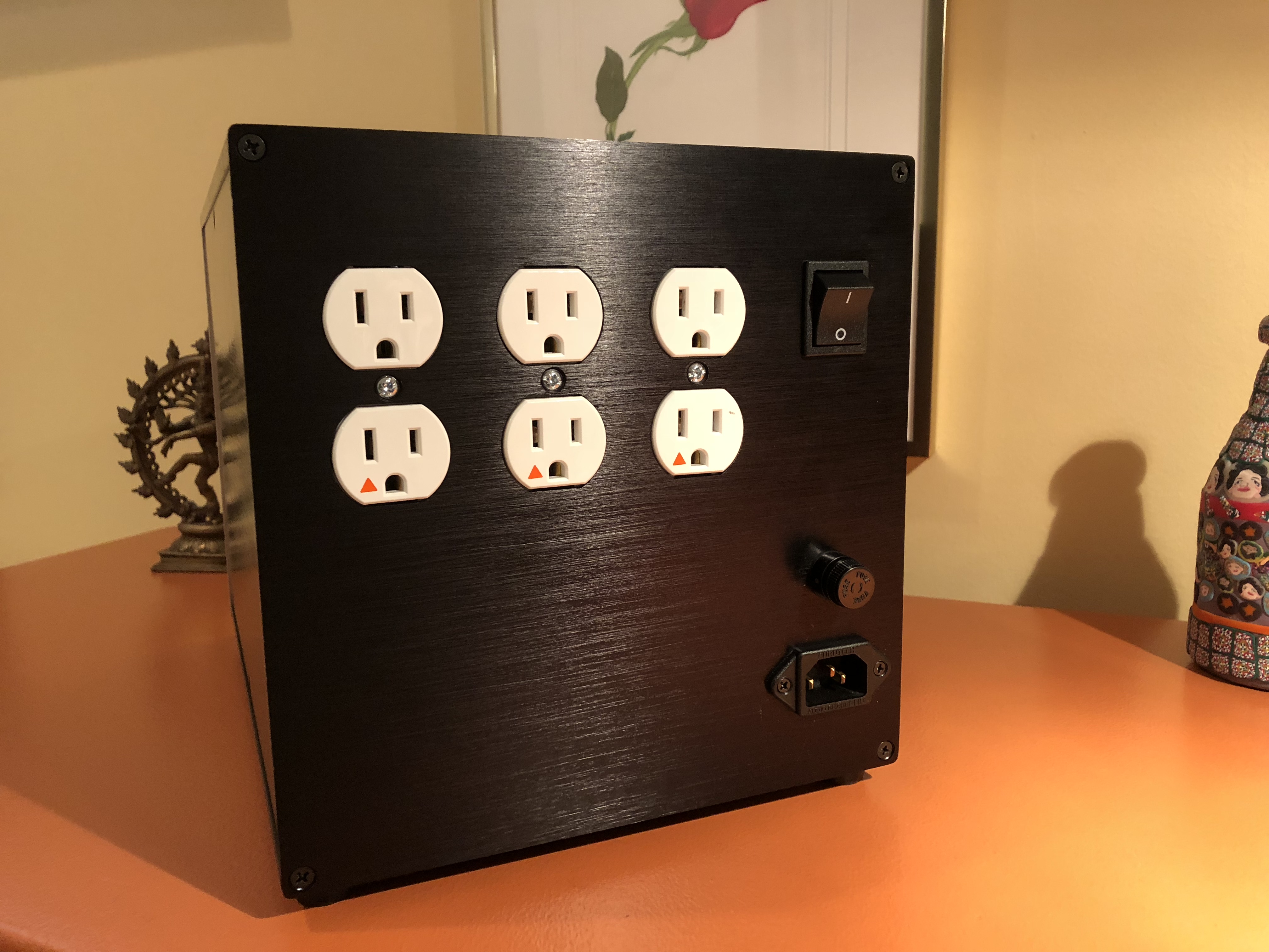

I just finished putting a Topaz “Series 30” 500VA low inter-winding capacitance transformer into this nice box that I purchased from a fellow HFer. Worked out well and looks good.
