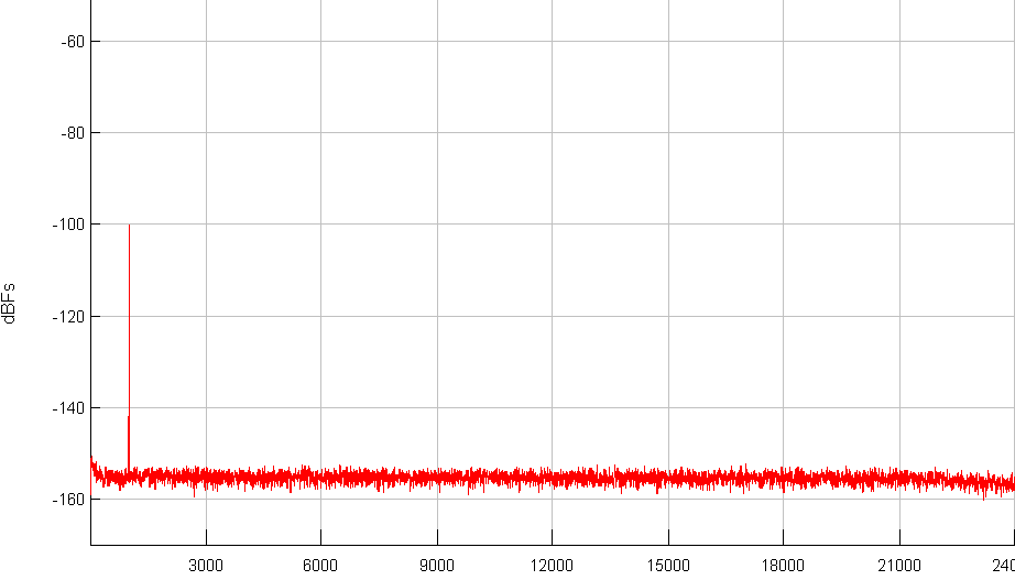

Agreed. The proper method is to introduce LSB error to screw things up so the ENOB gets reduced. I've actually written a WAV file converter to do this according to a transfer function / INL plot.

- You insist on the high bits precision error relative to the low bits but does that really matter when, by definition, high bits are active during peak times and there's only so much difference between loudest and quietest sound human can hear (level masking)?
You are either presenting a straw man argument or not grasping the concept of relative accuracy. The issue is what happens when a DAC is not monotonic to 16 bits? What if small tiny increases in volume according to the bitcode is translated into small tiny decreases instead? Or what if the bitcode calls for an increase of 0.021V for the next sample, but instead get increase 0.017 volts or perhaps even a decrease of 0.012 volts?
Again, think of this as "jitter" on the Y-axis. This has nothing to do with high level signals masking low level signals (since you made a reference to Clem's post).
- From my experience so far (i.e comparing the D1 resolving power to all other D/S dacs I have had / heard) tells me that, perhaps, this bit depth thing is a non-issue.
What satisfies you may not satisfy me. What I notice, you may not. You have to remember I'm coming from the Berkeley, Bricasti, Wadia (yuck), MSB, PSA, Aurulac, Invicta (yuck), DACs.
- Fair enough on the stuff one notices / pays attention being people dependent (and you seem to have a particularly solid ear)
- About the ladder precision thing, let say I will remain skeptic until I can hear this for myself.
- 14bits effective resolution is 80dB plus of dynamic range.
- That means this "Y-axis jitter" term you're using comes into play for signals that are 80dB below the peak value at any given time block.
- You're thus saying you can hear these "fly farts within the orchestra playing".
- Fine, but there are concepts like level masking that long exist and prove this makes little sense.
