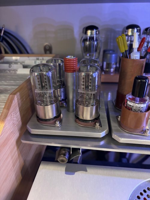

Aug 19, 2024 at 5:56 PM Post #10,233 of 10,669

I have some 1578s with that stamped and some without but the key is the plates have holes and the top mica like these, not the clear ones. They have to be metal.
Different plate on those with mylar on the ends I haven't heard, but I did have these
and they were very run of the mill tubes I quickly sold off.
I don't know if you've seen this, but the ones are the left are the ones to get.

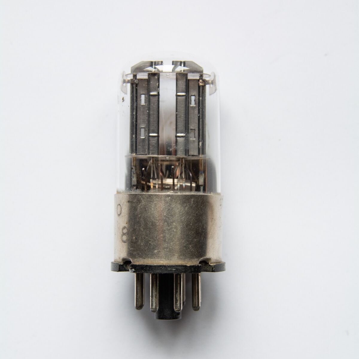

Notice the copper support rod. It is unique in the 6sn7wgt/14n7 and 6sl7wgt. Well look what I found when I pulled out some 7f7 made for the US Army Signal Corps.
There's that copper support rod. I have found this construction in 7f7, 14f7, and 12sl7 but not the 6sl7. They aren't exactly the same tube. The micas are just slightly different and most of the tubes I have found have black plates instead of the grey of the 6sl7w. I do have some of those too though. So how does it sound? Compared to the JAN Sylvania 6sl7gt with bottom getter (same vintage as the so called bad boys) the copper rod version sounds more refined, has better detail, and just smoother overall. That's with the black plate 7f7, haven't had a chance to compare to the grey plates yet.
I don't think they are exactly rare. Once I figured out what to look for I was able to find them with no problem. I don't think Sylvania made 7f7 for very long, they only ever seem to be of an earlier construction. These seem to be of the earliest batches. You might have trouble seeing any online right this second because, uh, someone bought the ones he saw. If you're patient I'm sure you'll see them crop up on eBay, reverb, etc. They were labeled all sorts of different ways, Sylvania, Zenith, Raytheon, Motorola, and probably others. The thing is those brands are also on regular 7f7/14f7 tubes as well. My initial tubes came in boxes branded with Hygrade Sylvania, a name they stopped using after 1946. It also seems like anything labeled GM is also probably the copper rod version. Those are the only two sure fire things I've seen so far. The others have to be determined just by looking at them. I just got a pair of 12sl7 that have the classic "chrome dome" getter flashing covering up the entire tube. The bay seller had happened to hold it up to the light so I could see the rod. I assume it's copper but there's no way of knowing for sure.
