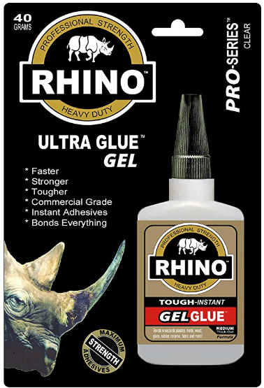

Found one of my tubes with a loose base did the ninja search and found that clear nail polish was the popular fix, works!
A good cyanoacrylate glue works well too. But emphasis on "good"....the Krazy Glue brand doesn't qualify (IMO). I've used the Rhino glue for just this purpose for years and have never had a tube base come loose afterwards. Of course, your wife's nail polish (assuming it's your wife's :relaxed:) is free for you, so there's that. LOL!

I had a few tubes bought off ebay with loose bases. Araldite always does the trick for me.. rock solid bases by the next day.

Yes it was free.. :D wish I had read further into the nail polish fix in applying tape to the tube so that only the base gets the sappy mess....now I have to clean up the thing with nail polish remover. :D first world problems. :D

All similar epoxy glue, but could have different resistance temp.
This one is no good:
https://www.amazon.com/Araldite-ARA-400001-Standard-2-Tubes-Epoxy/dp/B00AU0MW1K
high temperature resistance (-30 to 65 degree Celsius)

Lol crap that's the one I've been using.. Seems to do the job though. Epoxy still looks good. Used it on recommendations from another forum who have used the same araldite version.
