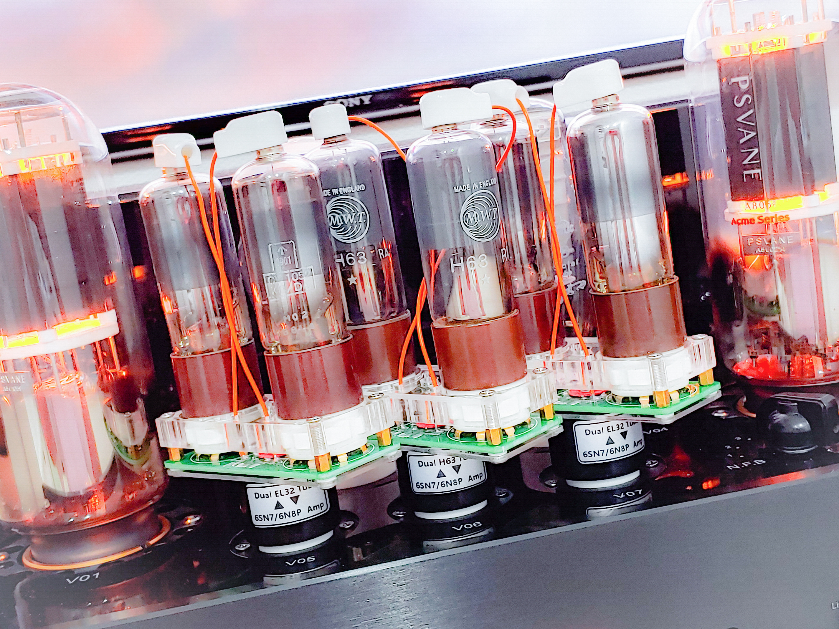

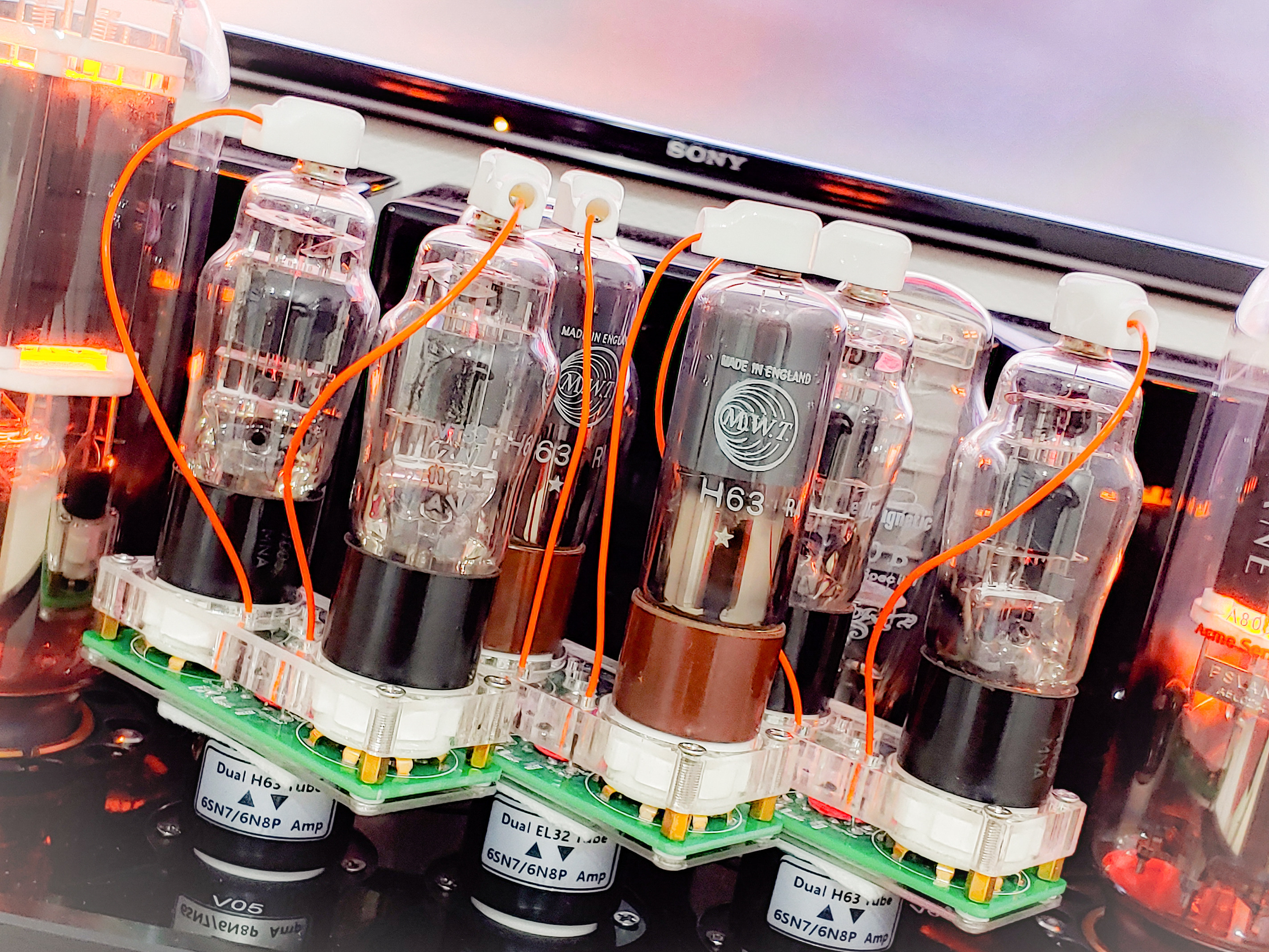

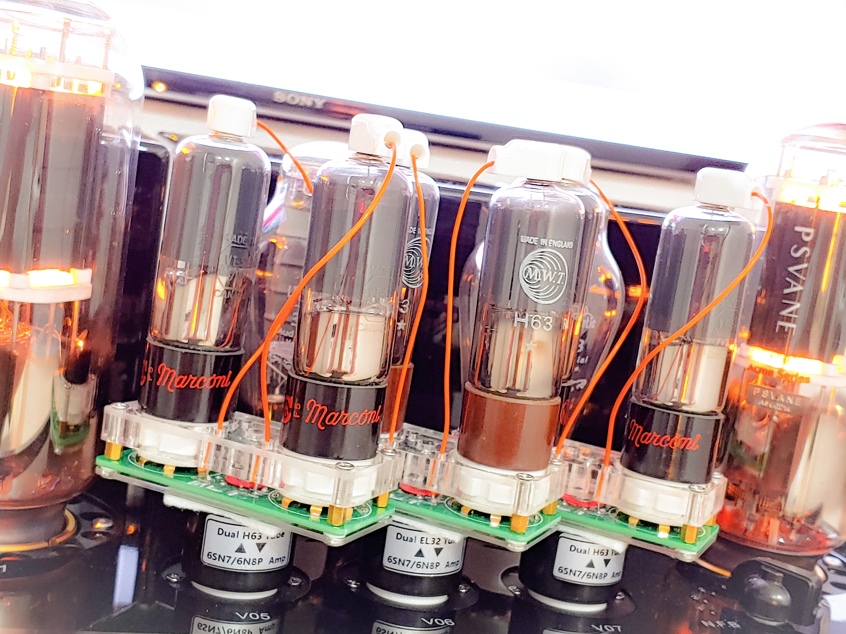

Pick your poison, they are all great!!!:smiling_imp:
Mullard CV6
Marconi CV1052/VT52/EL32
Mullard CV1052/VT52/EL32 (Straight Bottle)
Mullard CV1052/VT52/EL32 (ST)
Great SQ @ cheap price...:thumbsup:

Wait, are you using 2x triode wired el32 in place of a 6sn7? That's crazy. What kind of current draw does that have? Who thought of this?
Jul 16, 2022 at 6:44 PM Post #7,339 of 10,007
I believe you have mistaken for another tube. EL32 consumes only 0.2 amp per tube, 0.4 amp per pair compared to 0.6 amp for a single 6SN7.
As I have reminded, always check datasheet when rolling tubes...:metal:
