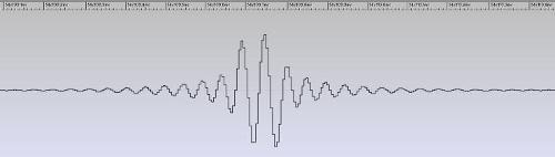

    Yes -- I do a lot of sound editing and am aware that there's no clear indication of ringing/time-smearing in the complex signals ripped from music CDs (hence recordings meant to have passed an anti-aliasing filter before sampling). I'll do my own test with recording from a CD using D/A and A/D conversion, though.
    [​IMG]
    Your two test samples differ quite a bit (although I couldn't hear a clear difference). Also, the original suffers from temporary clipping, which the recorded copy doesn't show (as digital zero, at least). Moreover some conspicuous 1-sample peaks could be a hint for resonance effects caused by the additional conversion and filtering, but that's just an assumption. All in all the difference is quite obvious -- either it's the quality of the D/A-A/D convertor(s) or the additional (!) ringing or both, hard to tell. In any event, complex signals like these make it hard to detect ringing, because it might be masked by the following signal samples.
    Come to think of it: I could handcraft my own samples -- making tone burst out of hearing-test signals -- and record them.
    [​IMG]
