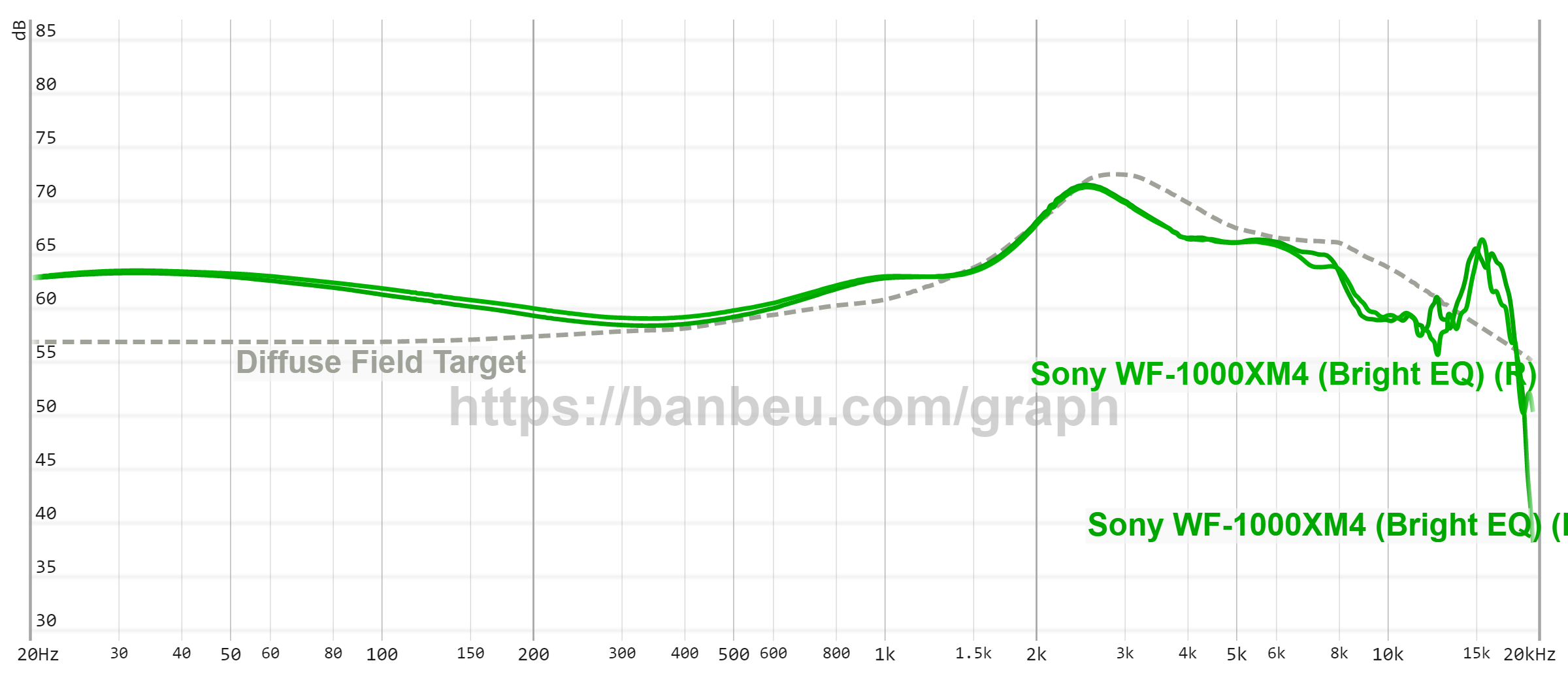

Another profile that I found interesting upon observation is the Bright EQ profile. Which seem close to Diffuse Field
If anything, I think Sony does know what they are doing with the XM4 here, that or this is just a coincidence. I am currently finishing my EQ impression portion to put in my quick review by the end of this week, hopefully, something interesting might come up.
