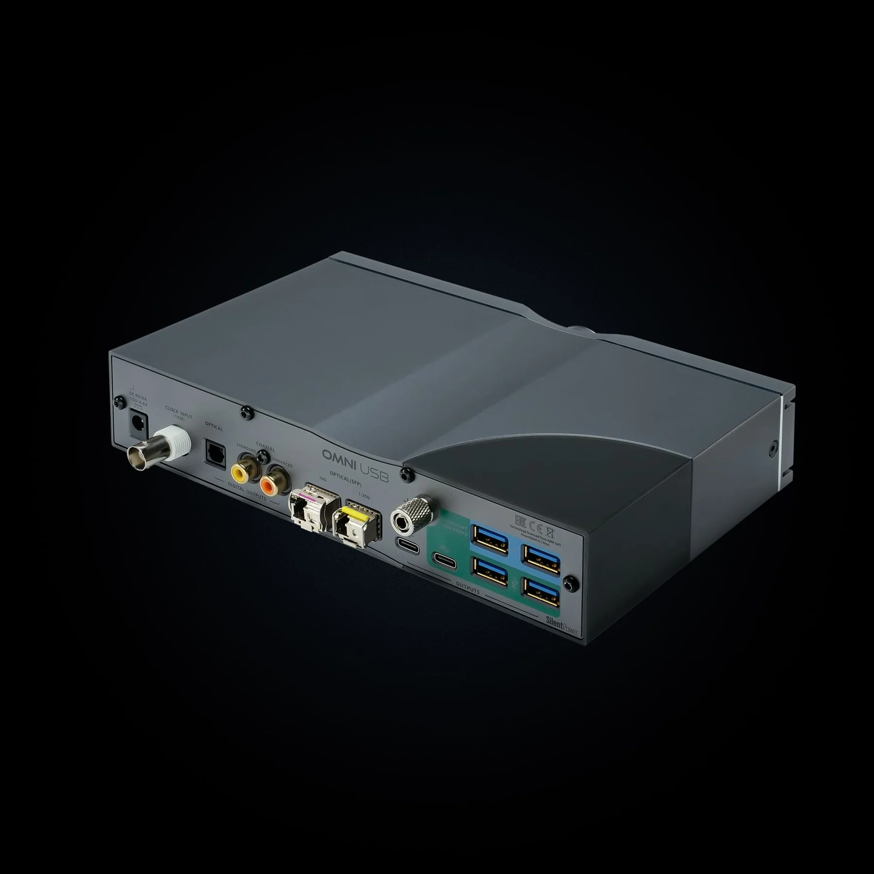

Does it have switching function, that is switching between input(s) and outputs?
1 input only. I think all USB outputs are active by default but can be turned off individually so you can actually manually switch

From the pictures provided they appear to be standard form SFPs (small form pluggable) and SFP sockets. So on the face of it one could SFP-roll if one was so inclined, even experiment with copper DACs (direct attached cables) if you really want to live on the edge as some of us with USB isolators with SFP connectors have done.
Nice one ifi, quite a Swiss Army knife of a USB conditioner you’ve come up with here. 👍🏻 I feel some thorough market research had been done, maybe even reading a forum thread or two. 😉

Can a dac be connected to one of the usb ports, and which port?
You can connect 3 USB DACs simultaneously (not 6 since the other 3 are just power only). Any USB port with data+power label on them that's where you connect your DAC
May 18, 2025 at 8:43 AM Post #21 of 28
And all usb ports are limited to 24bit 192KHZ?
Should not be. You can do DSD1024 if your DAC can support it. Fiber Optic network is NOT Toslink. Only common thing they have is the use of light

I read the documentation available on the Silentpower website, and I have questions. One is about the two Coax ports. In the manual it says one is Enhanced. In the spec sheet it instead calls the Coax port High Voltage instead of Enhanced. What is the difference? High voltage for very long cables?

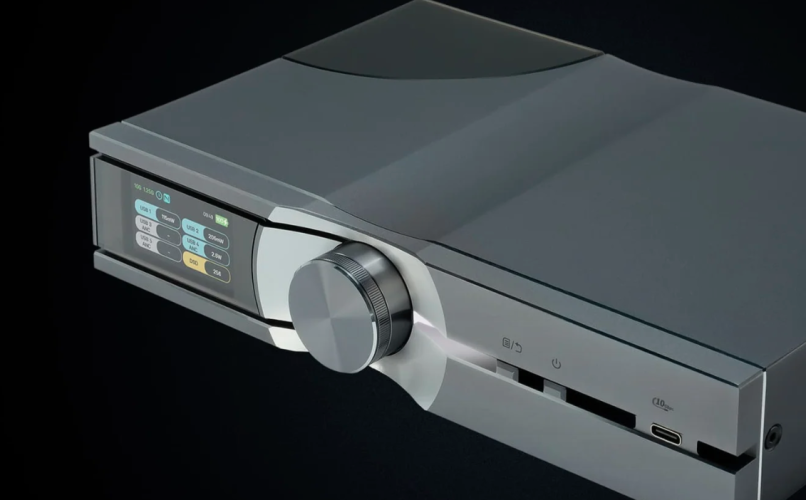

Also the two optical ports remains a mystery. As others have noted it's just normal SFP so you could roll your own wires and extend them possibly up to 10km. It depends on the transmission type. The 10G port should be enough for USB 3.1 Gen 2. Is the 1.5G port there for USB 2.0 mode? Or is it there as a dedicated communication line between the two boxes? The screen has status and signal quality monitoring features, and also a firmware update function. Maybe the 1.5G port is only used for these functions. As it's not releasing for a few months you have plenty of time to answer!
I think the 192kHz spec only refers to the USB to SPDIF conversion feature. The USB to USB ports should easily support the highest data rate the dac supports. I went through the manual again and saw no limitations stated anywhere, aside for on the SPDIF ports.
