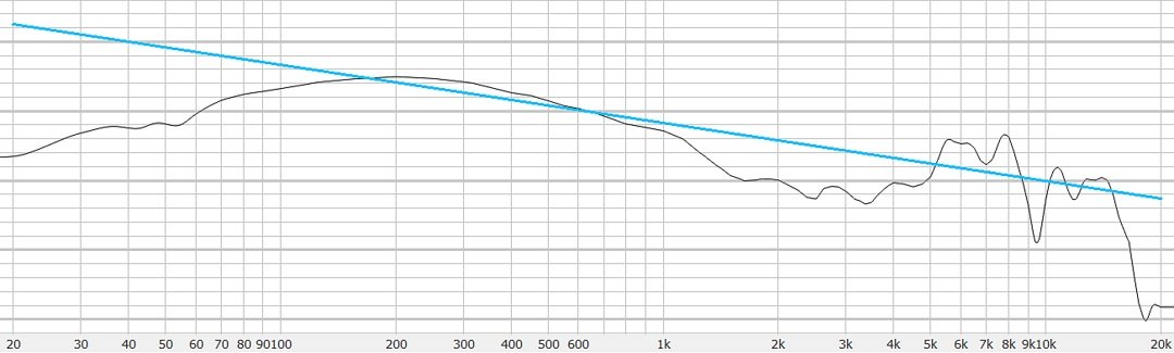

Diffuse field compensated graph of the Sennheiser HD800S's frequency response, based on Jude's HBK 5128 plot above. Calculated with the HBK 5128 DF response curve.
The blue line represents a -1.25 dB per octave slope. The sound power response of a neutral loudspeaker is usually between about -1.0 to -1.5 dB per octave. So I'm using the above slope as a very rough guide for that.
