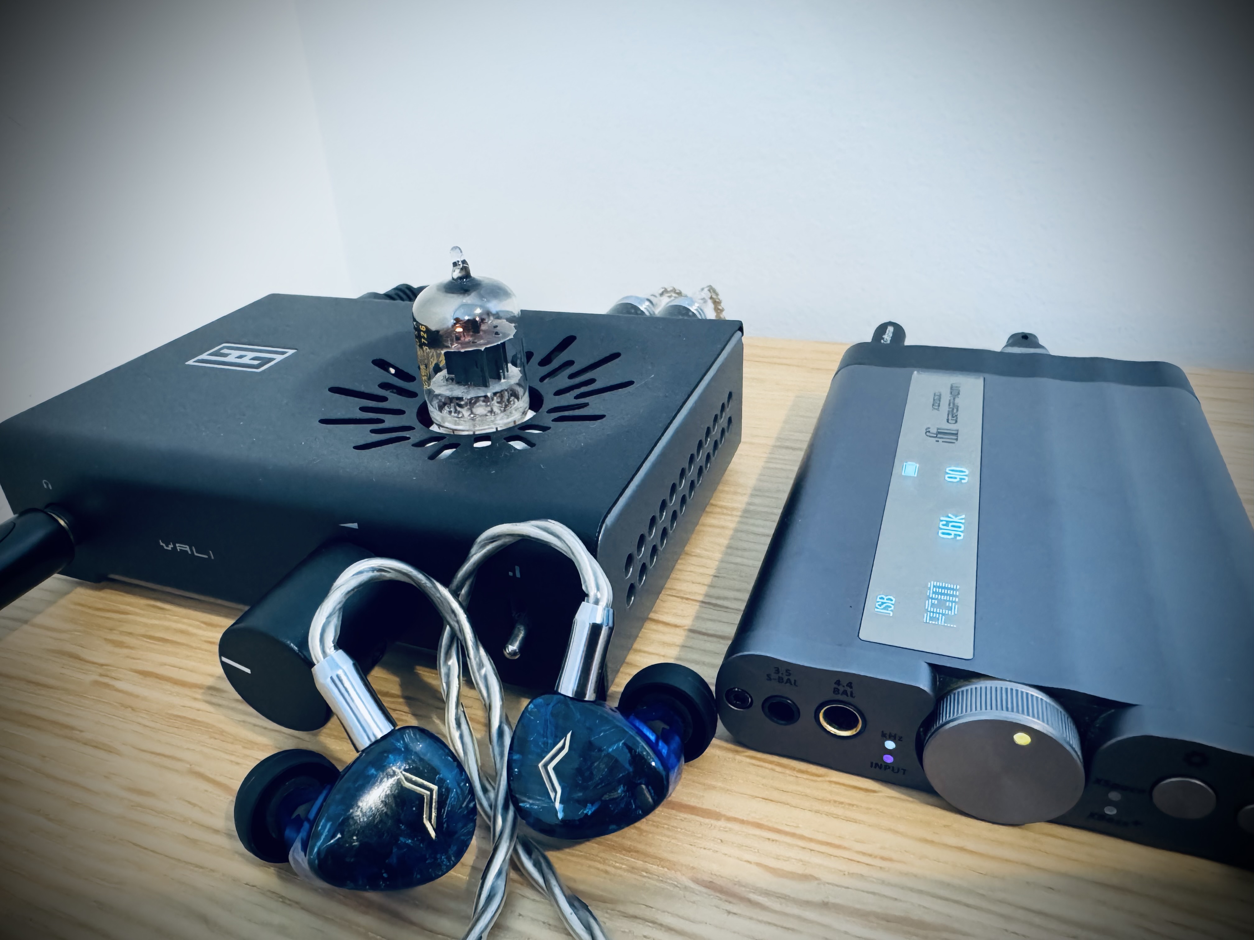

Sep 13, 2024 at 11:08 AM Post #3,223 of 6,498
Comfort glow on a Friday.
