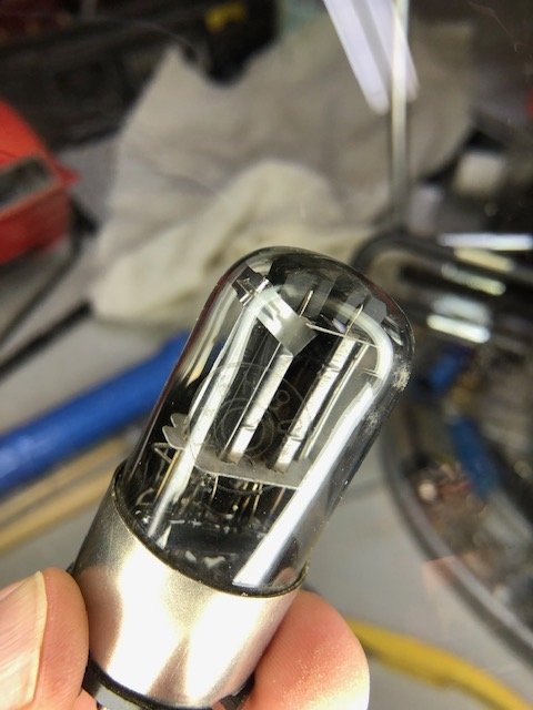

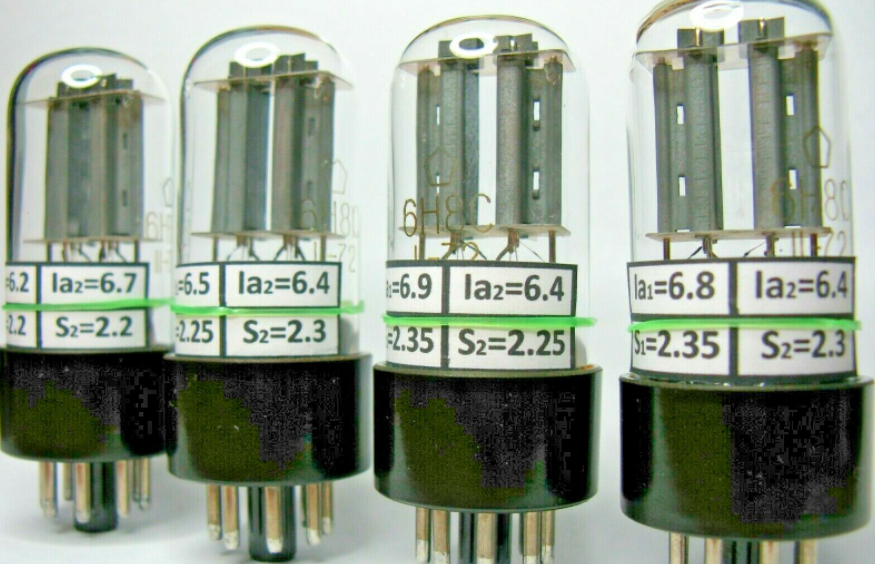

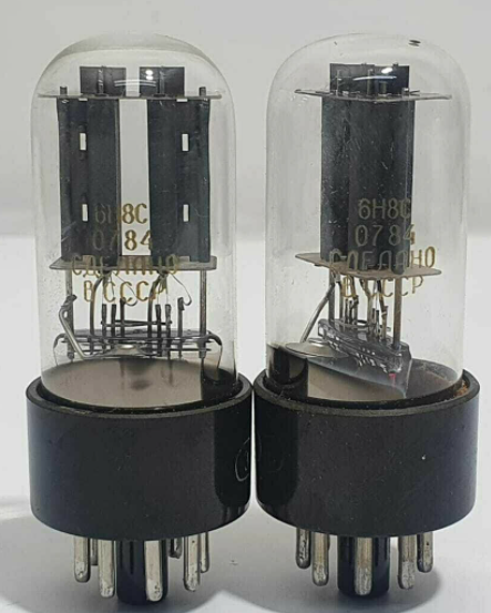

I have no issue with Russian tubes such as Melz from the late fifties and early sixties or Foton's from the fifties not having proper internal support or issues with microphonics. Most of my Melz use metal upper brackets but they also average around $150 per tube. Some of the less desirable Melz used mica. There are plenty of other brands of Russian 6sn7 equivalents I stay away from though.
Same thing here with the 1950's Fotons -- no issues with proper support. But to Jason's point, somewhere along the way the Russian manufacturers (apparently en masse) did away with the additional top mica support tabs (or springs with the Melz 1578's) which pressed tightly against the glass and kept the plate structure firmly in place. The first pic below are a 1952 and 1961 Foton showing the extra pieces. Below that are some 1980's Novosibirsk and then a pair of 1984 Reflectors that have only the rectangular mica, so any variance in the bottle diameter or mica length could cause a lack of proper support for the plates. It would seem the bean counters arrived at the Russian factories before the audiophiles could get there.

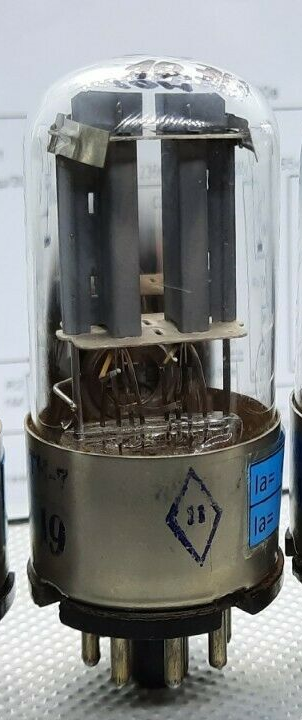

That is a newer issue Melz on the left (1970's), but when you look at the one from 1956 on the right, the metal support is working properly. On mica supports you can generally see the stress marks against the inside of the dome, when done correctly. I prefer the sound of the early Melz and there is certainly something to be said about their construction as well. Bill and I search for specific brands and specific years for a reason. Not that we are prone to agree on much but occasionally....
