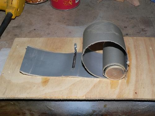

Speaking of Nichicon Super Through series, here's a handful of what they're made of (15000 uF - 50V):

Thanks for those pictures on the Nichicon KG Super Throughs. Would you please elaborate on your ESR reading and what your impressions are of the insides of the can. Are these good or bad? I was going to select these for my Power amp but have been trying to find data on the ESR values. The Mundorf HCs are more than double the price. Thanks
