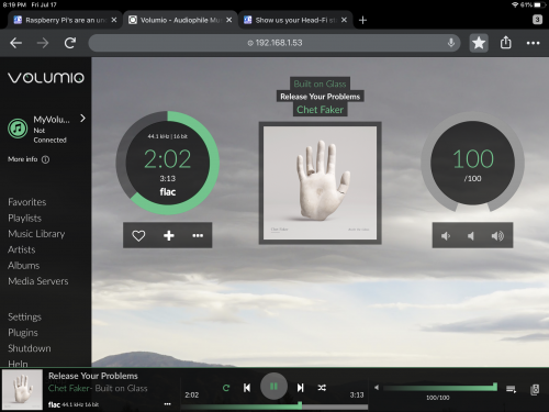

ad 6) Ropiee is rock solid, but it expects playback control on external application (for example on Mac - Spotify, ROON, Browser etc.). Volumio includes control application which you approach on volumio.local via browser or from iPad/iPhone. And Volumio plays FLAC files directly, as well as internet radios.
