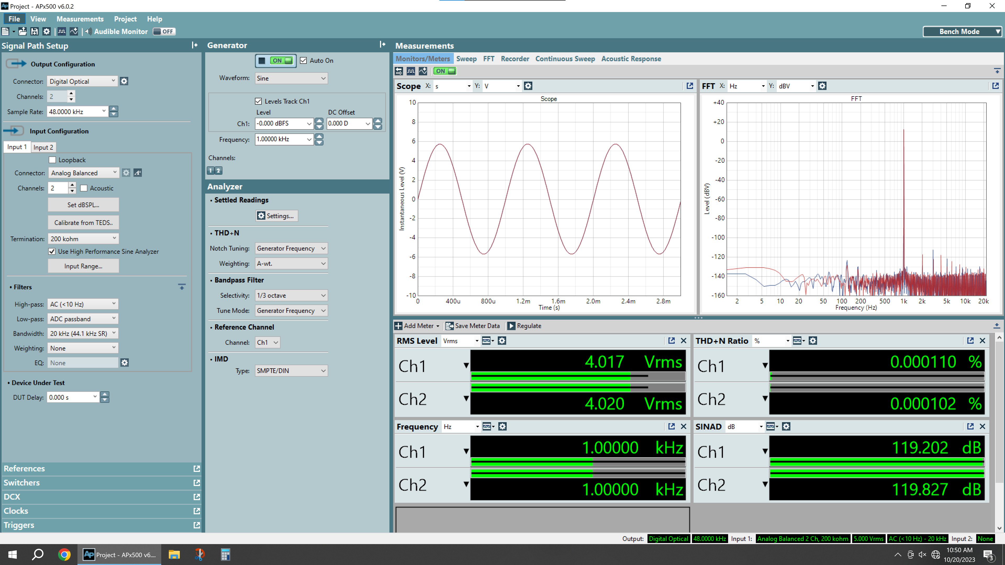

My Yggdrasil MIB R2R DAC has 119-120 dB SINAD BTW and so is Holo Audio May KTE R2R DAC
But that is NOT the SINAD, this is a good example of not understanding what the measurement is, or of what it tells us!
Firstly, what is SINAD: SINAD is the total of all distortion + all noise, expressed as a ratio (typically in dB) to the signal.
Secondly, what is this particular measurement telling us: “All distortion” would have to include IMD (as intermodulation distortion is obviously a “distortion”), otherwise it would not be “all” distortion, so a measurement of SINAD must have a wide bandwidth, to include any ultrasonic content that could produce IMD (in the audible band). However your posted measurement has been bandlimited to 20kHz, thereby eliminating all ultrasonic content and all IMD caused by it. It therefore is not a measurement of “all” distortion and therefore not a measurement of SINAD. In addition, it is not “all distortion + all noise” for another, separate reason. The analyser has be set to “A-Wighted”, so all the distortion+noise below 1kHz and above 7kHz has been rolled-off, it is therefore definitely NOT “all distortion + all noise” and not a measurement of SINAD.
It’s as if someone has deliberately applied those settings to falsely demonstrate a much higher SINAD than is actually the case. My guess would be it’s been posted by a Schiit shill, as I’m not sure Schiit themselves would be so blatantly misleading. The actual SINAD of the Yggdrasil is around 89-90dB and 86dB according to GoldenSound and ASR respectively but maybe of different update versions. At the highest end of the “reasonable listening level” (with headphones) at about 85dB SPL, that should still put the Yggdrasil’s issues (distortion and noise) below audibility, at around -1dBSPL or lower. Nevertheless, who in their right mind would consider a ~$2,000 DAC with significantly poorer performance in this regard than a $9 DAC to be a good buy?

Right over your head”, that’s got to be the best example of hypocrisy in the history of hypocrisy. If someone sticks their head far enough up their own a$$ then everything, even the most basic of facts, will go over their head! Do you know what “the intricacies of musical presentation” even means, do you know what defines music, let alone its intricacies, and where it exists? Do you know what a DAC does, do you know what the letters D, A and C stand for and which one of them do you think stands for “musical presentation”?
You’re just repeating the same crap, which contrary to your assertion, you’ve proved you do have time for. A DAC outputs an analogue electrical signal (the “A” in the acronym DAC), it does not output “the intricacies of a musical presentation”. Maybe you’d like to explain how there can be an “ability to measure” something at the output of a DAC that it is not outputting? Should there also be the ability to measure the output of a DAC for the flavour of ice cream, as DACs don’t output ice cream either?
And lastly (and again!), “preaching” utter BS to “committed believers” in the science/facts, in an actual science discussion forum is TROLLING! You should have “seen your way out of this thread” (and in fact any thread) long ago, before you even started posting/trolling!
