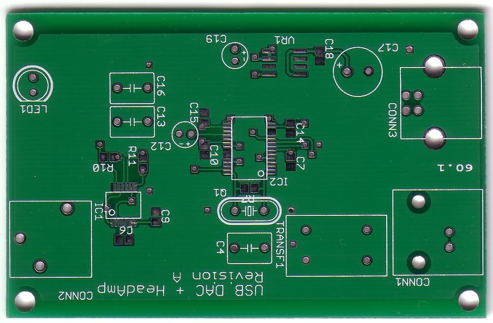

OK, here's (hopefully) my final revision before attempting a proto. I've tried to clean things up more and I also mitered all the corners and made sure the silkscreen is good to go. As always, comments/suggestions appreciated

Jan 13, 2006 at 4:27 PM Post #17 of 48
Your C15 should be going to ground, not in series with the Vcc trace. Won't work as it stands! Inductors on the USB data lines aren't a terribly good idea as they will blunt the pulses, possibly leading to errors. Resistors are sufficient to isolate the PCM. I would recommend not having the Dout trace crossing the crystal trace as well; the crystal trace is the most sensitive on the board
Jan 13, 2006 at 5:25 PM Post #18 of 48
Thanks for the reply!
The C15 label actually applies to the large electrolytic cap, not the bottom layer. Sorry for the confusion there...that bottom layer is actually a ferrite. As for the ferrites in the data lines, I guess I could try it with them jumpered and with them in and see what happens for now. Finally, I think you're right about the DOUT line...I never liked crossing the clock signal with that for fear of contamination on either of them. I'll see what I can do to rework that section. Thanks!

Jan 15, 2006 at 5:21 PM Post #19 of 48
OK...here's the final edit before I submit today for a proto. I added the small USB termination/filter IC that I linked to in my previous post and also tried to improve some of the routing.

Jan 16, 2006 at 12:34 AM Post #20 of 48
There is plenty of room to have the digital output go up the left hand side of the chip, then put the resistor across the crystal there on the bottom layer and move the crystal in as close as you can
Jan 16, 2006 at 6:18 PM Post #22 of 48
Ahh...both good ideas. I put in the order for the proto before implementing either of them, but I will most likely make the changes for a future version.

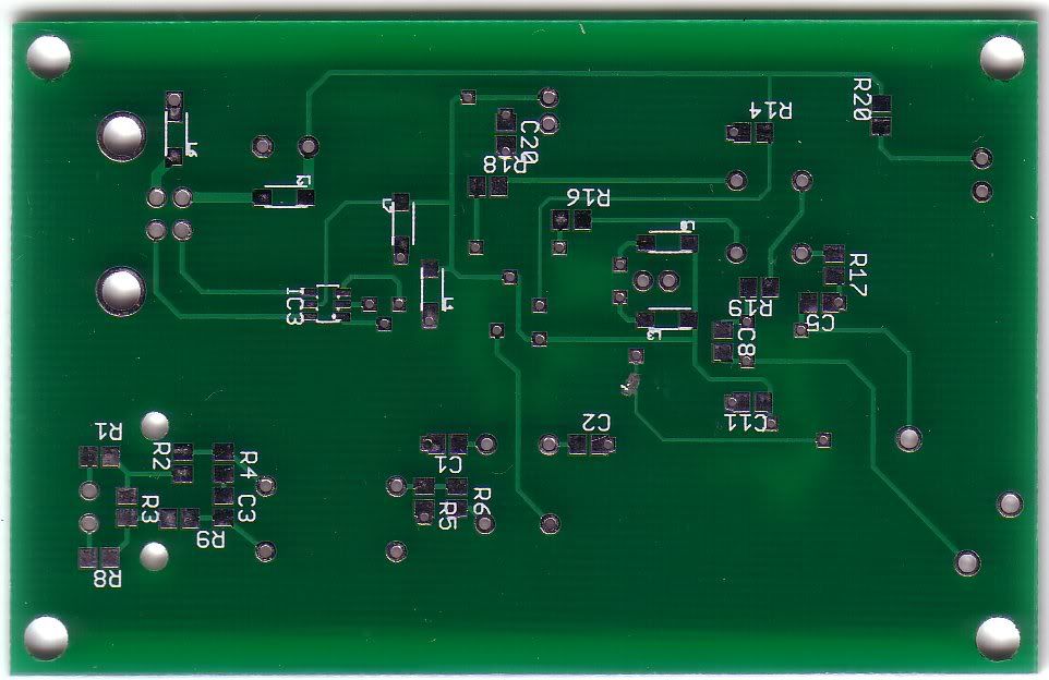

Feb 2, 2006 at 1:48 PM Post #30 of 48
nleahcim: I ordered from BatchPCB on Jan 15th and got my board yesterday. Two weeks for double sided soldermask and silkscreen isn't bad turn around if you ask me
As for the thermals, I didn't have any issue soldering on Alf's board and I wouldn't expect much here. It's a question of 'local' heat, and the groundplane isn't thick enough and/or big enough to dissapate enough heat to prevent soldering.
chaostic: No, they never asked me anything like that. When I submitted my request, they asked me (in a web form) for my name, address, etc.
Lastly, here are links to some scans of my board if anyone is interested...I hope to get some soldering done tonight
Bottom
