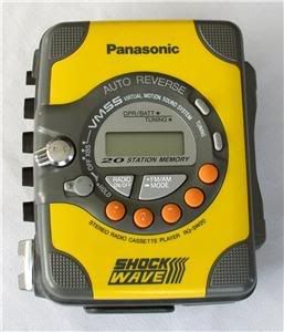

The original VMSS consists of two products: 'ShockWave' walkman RQ-SW20 and RP-HT970 VMSS monitor headphone (with independent VMSS in-line controller). Both were considered to be the top of Panasonic's line of product.

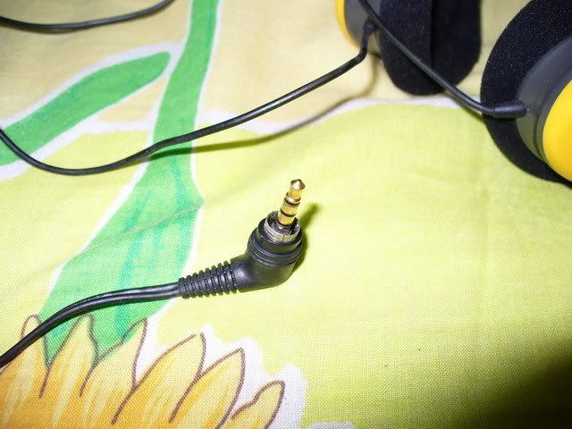

I bought the walkman when it first came out, and abandoned it after 2 years of usage due to headphone jack connection failure. To use VMSS on this walkman, the special headphone must be used (see connector picture below). A replacement headphone was bought several years later but I lose interest in tapes and went on to CD. Few years later I was lucky enough to bought a few RP-HT970 before it was out of production. Due to the low build quality of Panasonic 'phone at its era, my first pair of RP-HT970 is very much in ruin.

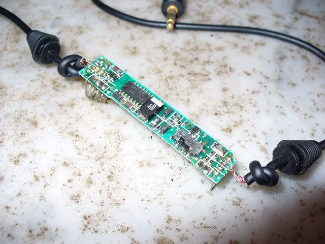

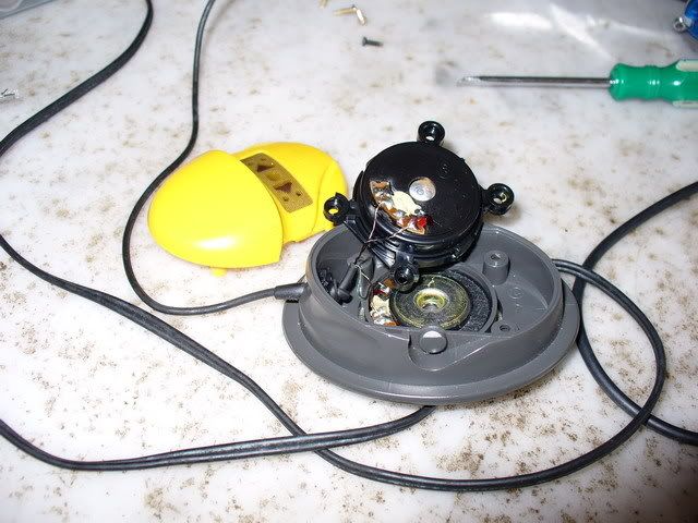

Since I have a working walkman VMSS headphone that can't be used else where, and a VMSS headphone that suffer from poor quality build, I reckon I can use RP-HT970's VMSS control circuit to rewire the walkman headphone and create an hybrid of the two, so here are a few picture of my VMSS mod. Enjoy
Now I have a one piece fully working VMSS headphone
