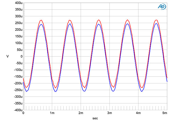

And regarding to "when bit-depth stops to matter", assuming that the measurements available in stereophile reflect the linearity of my unit, to me the sweet spot seems to be 19bits with gaussian dither (as May's linearity is flat until 20bits but I prefer to keep it at 19). But these preference things tend to come and go. I've also noticed that different settings synergize differently with different headphones. Right now I've been using MDR-Z1R.
