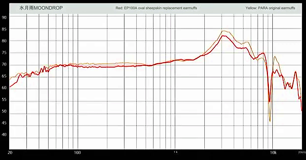

:relaxed: You who are great specialists of the Moondrop planar, can you help me to understand the Para pads:
- Ok there are the "spare perforated protein pads"
- Then , are the "default hybrid pads" the same as the EP-100A pads?
Thanks!
Nov 10, 2024 at 5:25 PM Post #573 of 817
:relaxed: ..., can you help me to understand the Para pads:
No.
Para's hybrid pads (default pads for the Moondrop Para) (micro-perforated inside face).
Moondrop EP-100A pads (not micro-perforated inside face) = upgrade pads for the Moondrop Para, to slightly reduce the brilliance of the Moondrop Para headphones in the treble, between 3 and 6 KHz and above 10 KHz.
Note : uncompensated Moondrop Para FR curve, with default pads (hybrid, internally microperforated) : yellow curve, and with the EP-100A upgrade pads (hybrid, not internally microperforated) : red curve.

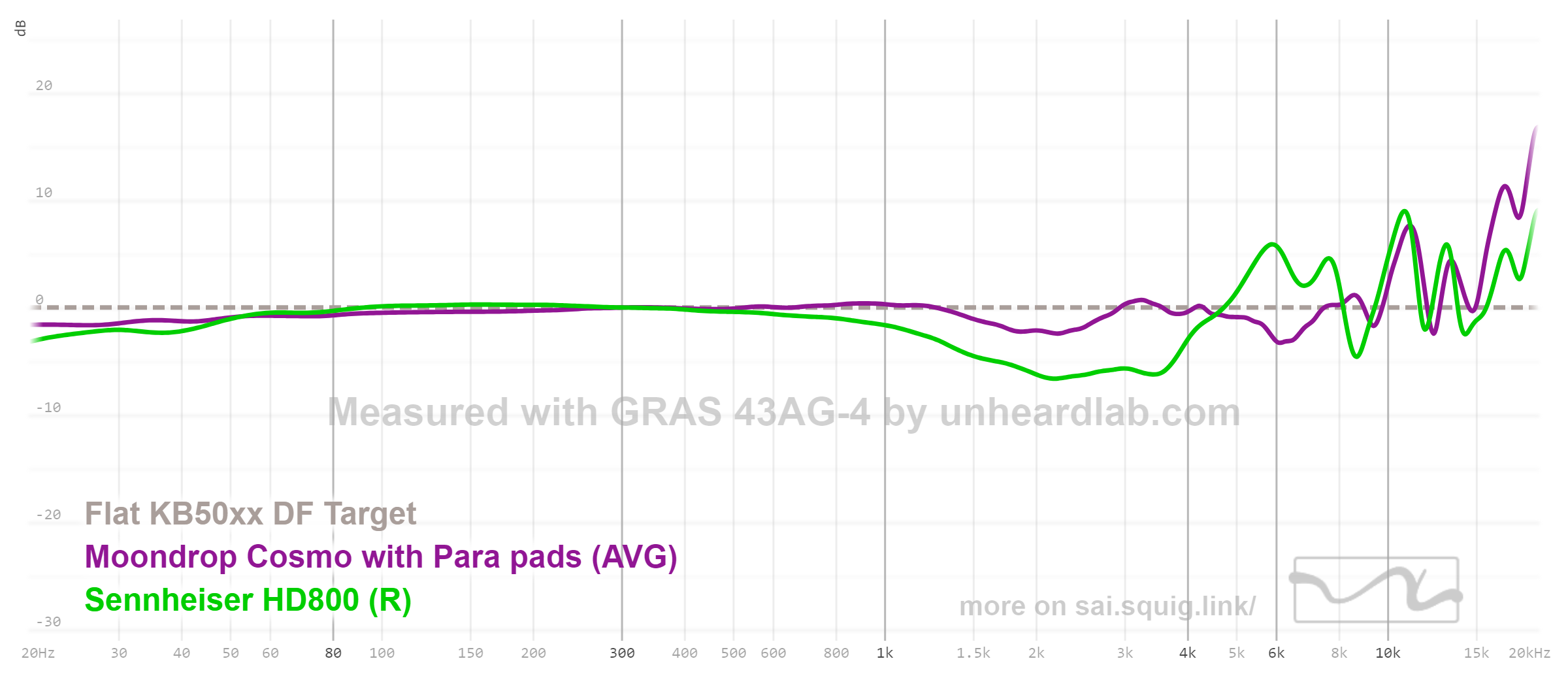

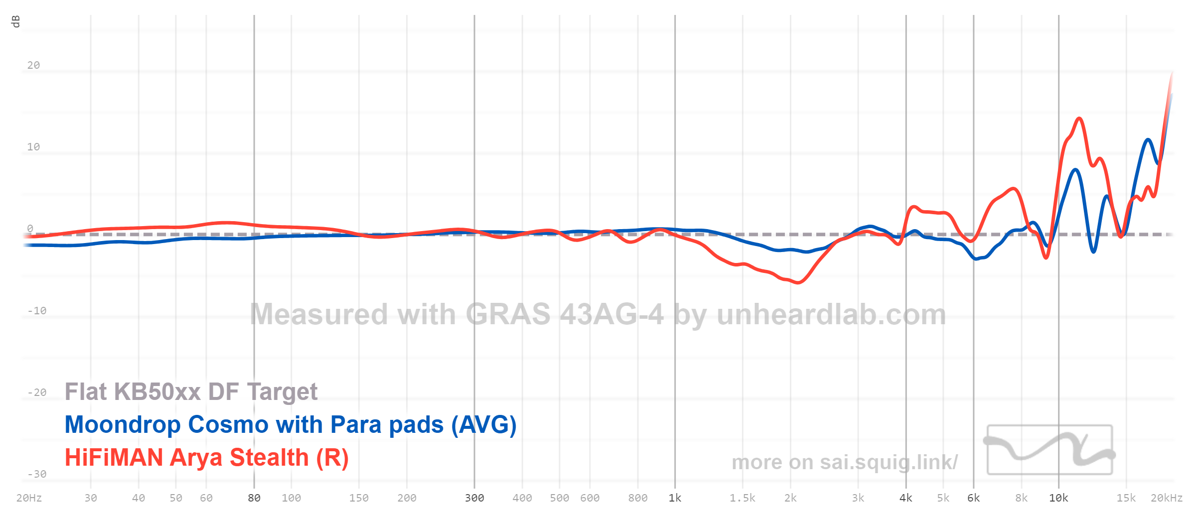

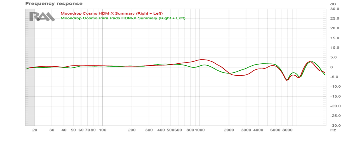

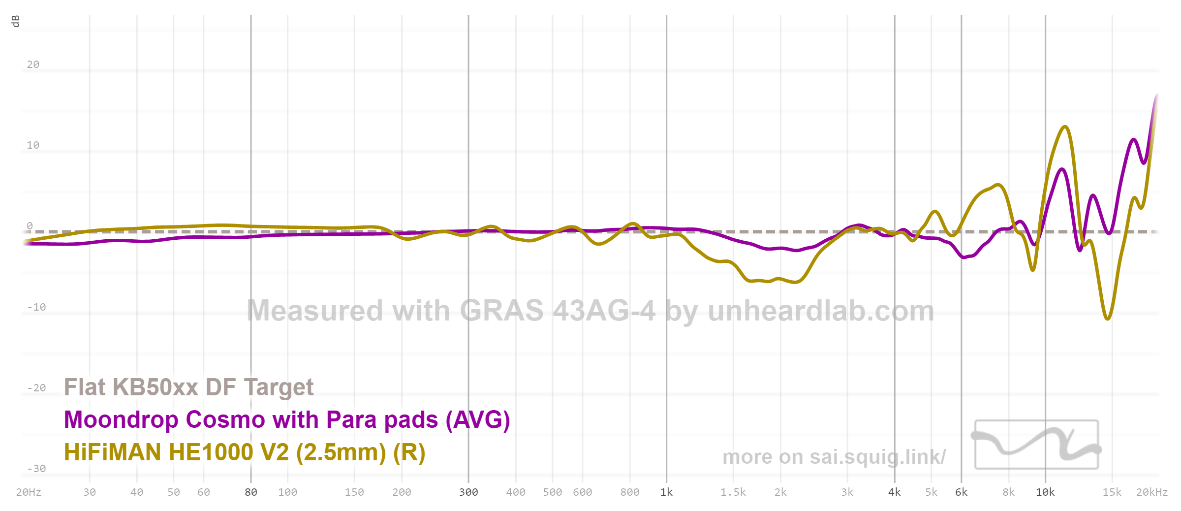

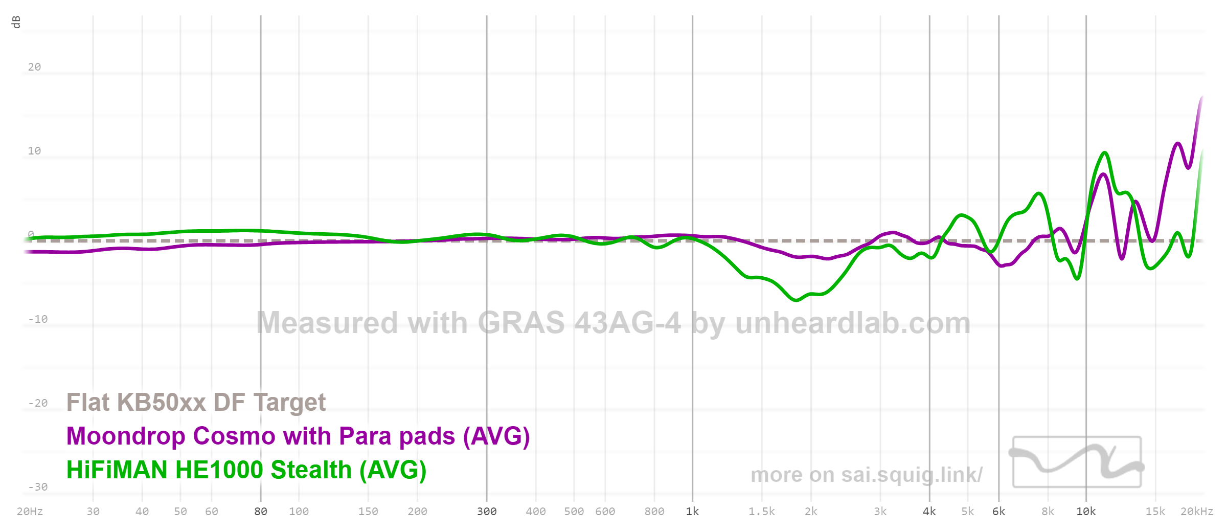

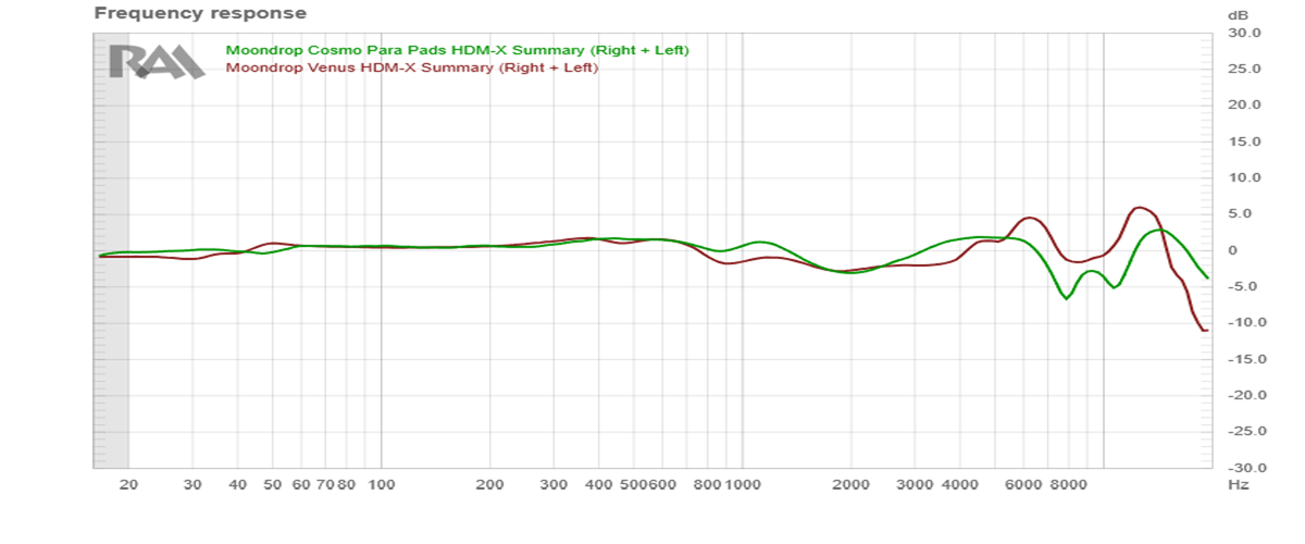

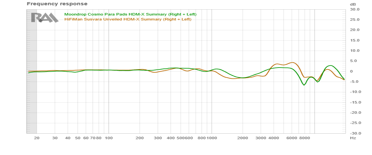

Would you like even more objective and credible information about the Cosmo versus other headphones, be they very inexpensive (like the PARA) or very high-end (like the Susvara OG and unveiled)?

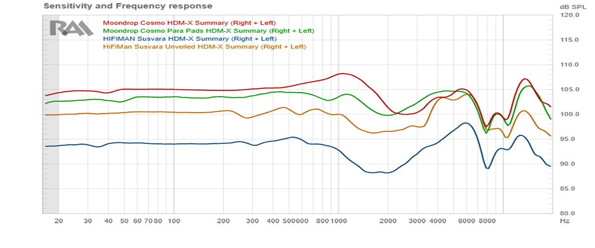

As for the technical nature of the COSMO - VENUS - SUSVARA OG headphones, I've put together a little “mathematical” demonstration here: https://www.head-fi.org/threads/moo...-size-discussion.970569/page-27#post-18103837
For the sensitivity of the headphones (COSMO, with its stock pads and the Para's hybrid upgrade pads - Susvara (OG and unveiled)): you have this graph below.
Note: headphone sensitivity expressed in dB SPL / Vrms, as a function of the FR.
For the frequency response of headphones, which imho is a major criterion of headphone quality and fidelity (in the sense of Hi-Fi, i.e. respect for timbre and tonality), you have (below) these frequency response graphs of well-known headphones, compared two by two.
It doesn't, of course, replace listening impressions, which depend on your personal preferences, tastes and ear sensitivity (which can vary with age), but it's a good yardstick for getting a first idea of a headphone's sound characteristics.
