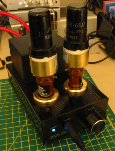

The 6SJ7 octal pentodes work in both the I+ and the MK IV. I've been testing it out with a pair of Ken-Rad VT-116 while I wait for more tubes to arrive from America. To fit them in the I+ without modifying the amp I needed to use a pair of Pomona socket tester adaptors. Without this the pins on the 6SJ7 adaptor won't reach far enough into the socket. So far I've tested the VT-116 with 6N6P-IR and MELZ 6N8S as output tubes in the MK IV without problems. The effect on sound is similar to using 6SN7GT driver tubes. The sound just feels bigger and the sound stage is wider. Listening with HD650s it's as though the distance between instruments has been increased. Not bad for tubes that can be picked up for as little as £5 each.

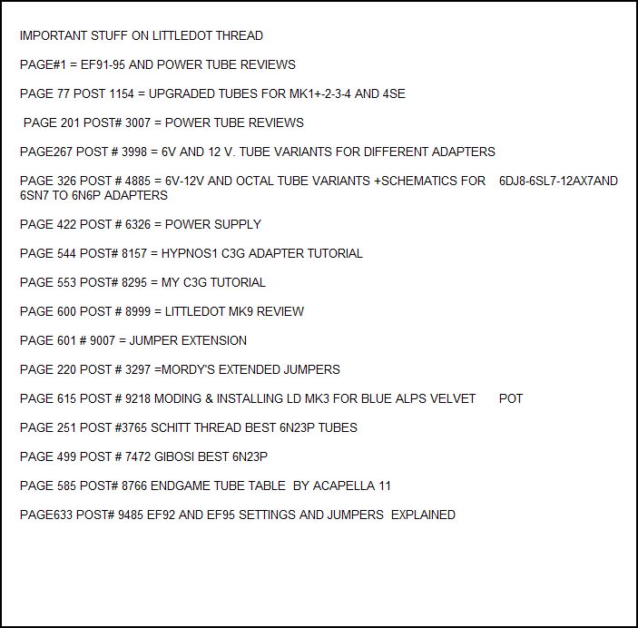

here inside there are two pages that summarise the info about tubes... the first one is the 77... the second one I can only remember is the 400+ area... I need help, where is the second one? I can’t find it
Could it be this? I have saved it as a document.

Images of the 6SJ7 in the I+ and the MK IV SE. The weather was much brighter this morning so I was able to take some pictures with my ancient digital camera.
I also tried solving the issue about reaching into the MK IV to get to the jumpers. I had the idea of attaching jumper wires to the internal pins which would then allow the jumpers to be changed externally. However the access holes on the bottom of the amp don't leave enough room for me to be able to fit the female end of the jumper wires to the internal pins with tweezers. I'll have to rethink that one.

Dont know if you have this .Its a list i made regarding interesting infos in this thread@triod750
