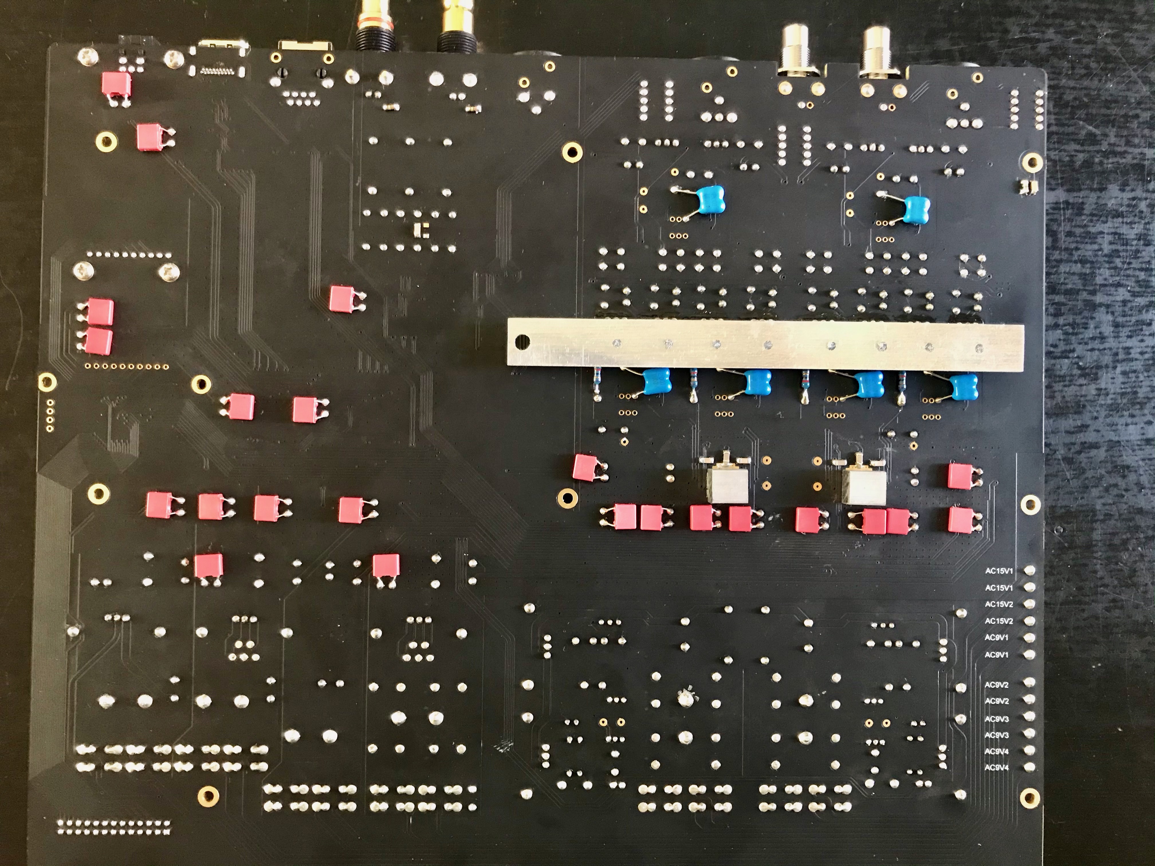

You can put here a photo of the top and another of the bottom of your main board, I think you have not done this, so the users here will know what version you have and will better help you in future doubts you may have.
As promised a few photo's of the board.
It actually says 15V en 9V on the bottom side!

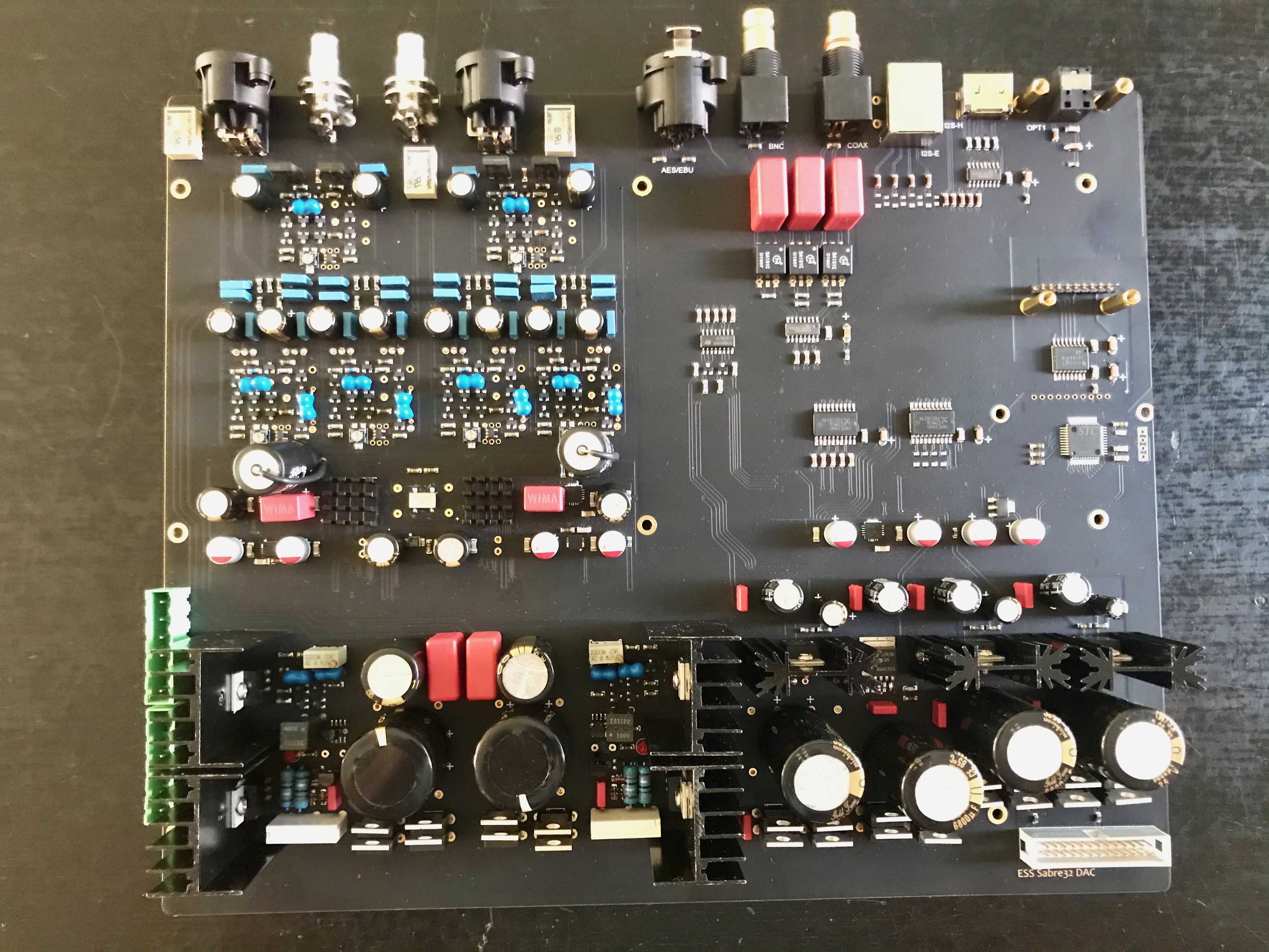

If you master microcontrollers, design your own screen from scratch, with keyboard and infrared receiver and communicate it directly to those ES9038PROs, it can be a fun job, anyway that IAN CANADA module if it ever worked, I don't think it will do 100 % of the functions correctly, also that display is ridiculously small you will need binoculars at 2m distance :sunglasses:
Photos in case you need to see something of the original .....

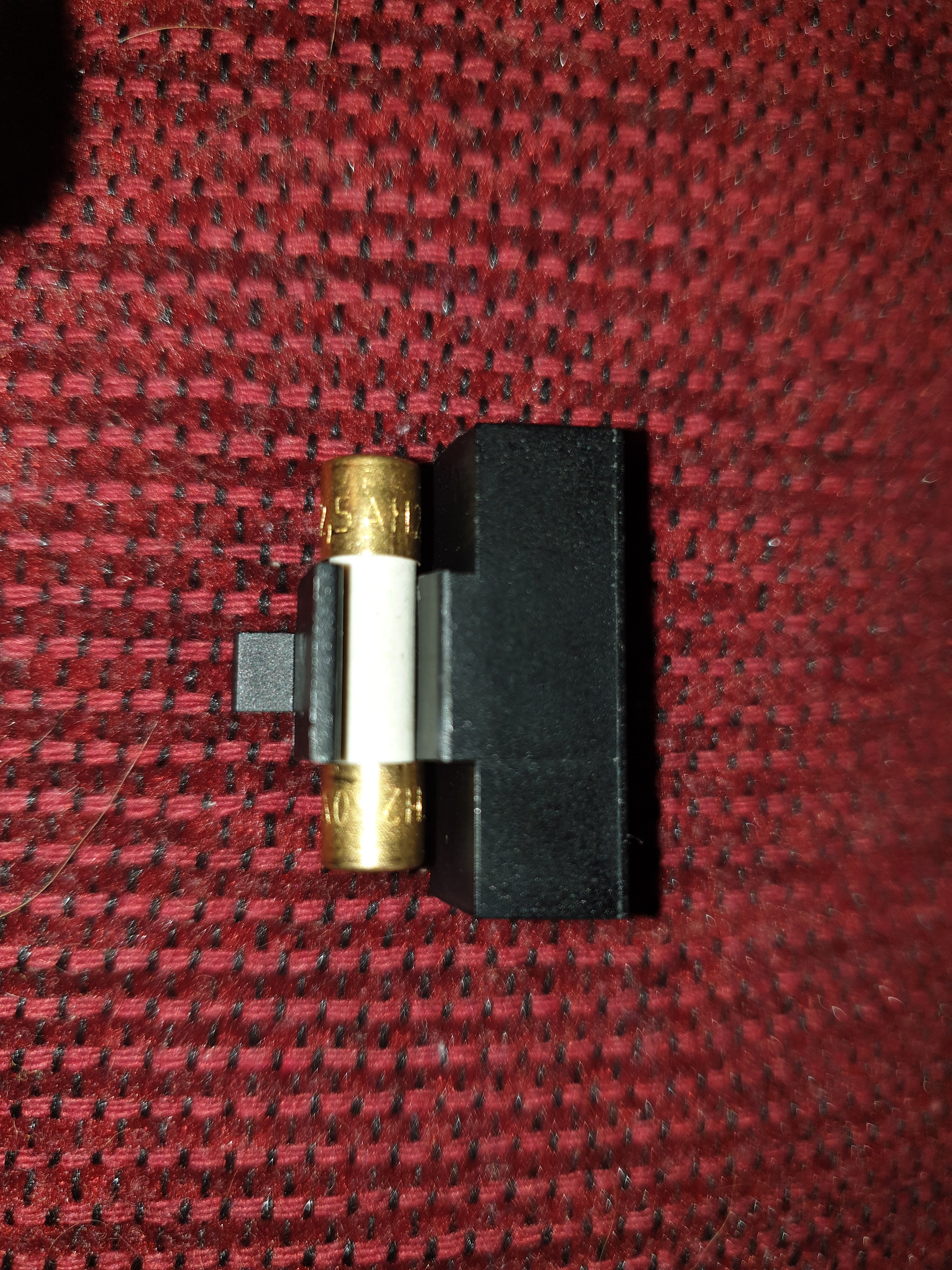

I’ve read somewhere someone used a 3.15A fuse (250V), I presume it’s slow blow, can you confirm the value?
Jun 11, 2021 at 3:32 AM Post #3,900 of 4,434
Okay, I’ve decided to go without display and control (for the moment) and use the coax input, I’ve ordered the transformers (7V although 9V was specified on the bottom side of the board). The measurements lead to believe 6,5/7V is more appropriate.
I bought my unit from a friend and I did not release it myself, I had never looked at the fuse (luckily) I am not a fan of expensive audio fuse brands. If my friend don't change it here I have a nice gold T2.5A fuse, we also have 230v around here further south.
