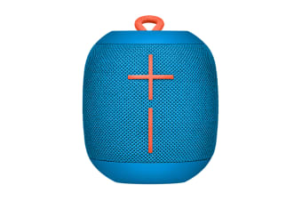

Totally agree. Bluetooth sounds perfectly fine for pretty much any portable use. I have one of these things...
it looks ridiculous. But it sounds remarkably good...put it in a corner on a wooden table and it will fill a room commendably. Combined with my little Fiio dap its a great portable sound system.
