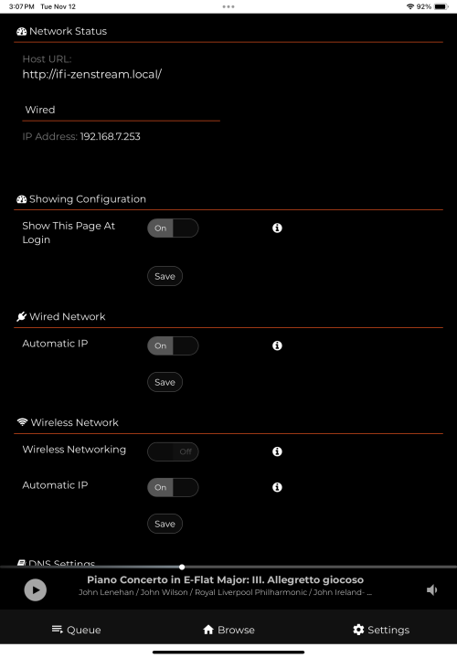

Although I have been sometimes able to run the Tidal app on my iPhone to control the streaming to my Zen Stream with wired ethernet connection, I have been having all sorts of connection problems and it usually takes me many tries to get it to work after the unit is powered down and restarted. Basically the Tidal app on my iPhone often times does not see the ZEN Steamer as an option. I just recently purchased the ZS and was thinking of returning it because it takes me about one hour each time to get it working.Yes, settings inside the app override ZEN Stream's rear knob, thanks!
Then I finally decided to use the reset button on the back of the unit, and this time I did not first upgrade the firmware to v2.30.7. I followed the ethernet connection instructions using the factory installed firmware and now everything connects perfectly each time I power down and power back up. The ZS shows up as an option on my Tidal app running on iPhone.
But I noticed that the version of the factory installed firmware (prior to an upgrade) does not handle MQA passthrough, and the color on the knob of my ZEN DAC Signature V2 is now magenta instead of blue (with Tidal Hi-Res recordings). The upgrade notes for the new v2.30.7 firmware release says that it added MQA Passthrough for Tidal (2.30.1 -- Added MQA device auto detection to Tidal Connect, enabling 'Passthrough MQA' setting from UI).
So with the factory installed firmware on the ZS, the magenta color on my DAC indicates that the "original sample rate" is being used from the Hi-Res Tidal recoding, according to the DAC manual. How does that compare in quality to MQA Passthrough available on the new ZS firmware, and using ZEN DAC Signature V2?
Now that my ZEN Stream and ZEN DAC Sig V2 are setup and working fine with the factory installed firmware installed on the ZS (and Tidal is controlled from a iPhone with Wi-Fi access to the same router as the ethernet connection to the ZEN Stream), I "might" try and upgrade the ZS firmware and see if the configuration still works. Do you know anything about a problem in setting up the ZS and Tidal via ethernet connection from scratch after the new firmware is upgraded?
