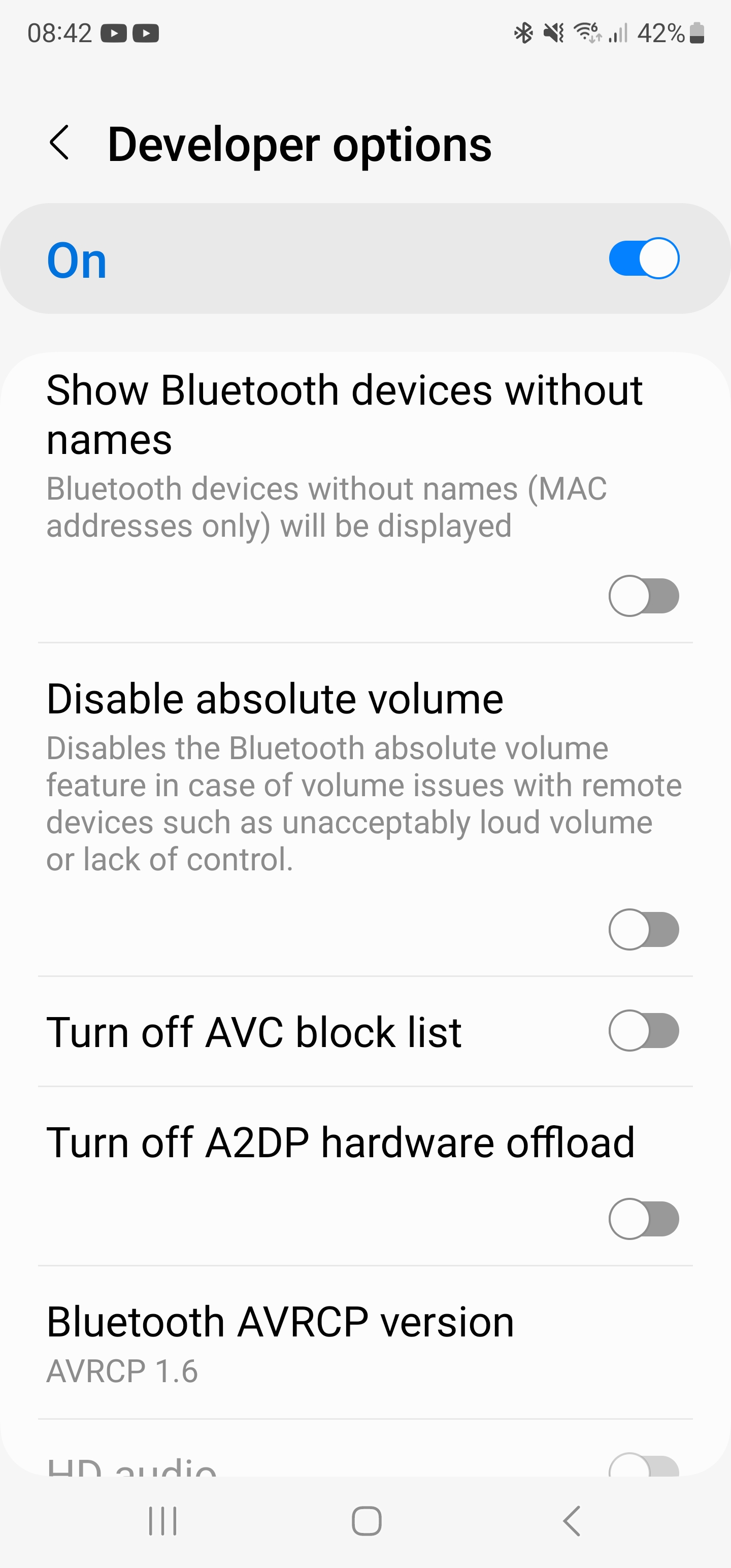

I did a bit more testing and here is how it works on my Samsung S23 Ultra.
The GO Pod remembers the last volume level only if I will set the "Disable Absolute Volume" to OFF. Like in the screenshot.
If I will turn this setting to ON the GO Pod plays at a very loud volume level and I have to lower the volume each time I take them out of the case and then put them on my ears.
I set the Absolute Volume to ON because I like my phone's volume to be set to max and to control the playback volume from the GO Pods.
Shouldn't the GO Pod remember the last volume setting? I am not sure how this is supposed to work.
@iFi audio , @Mr BubbaHyde can you clarify, please?
I've asked and as soon as we know something, either me or @Mr BubbaHyde will provide some info, thanks!
