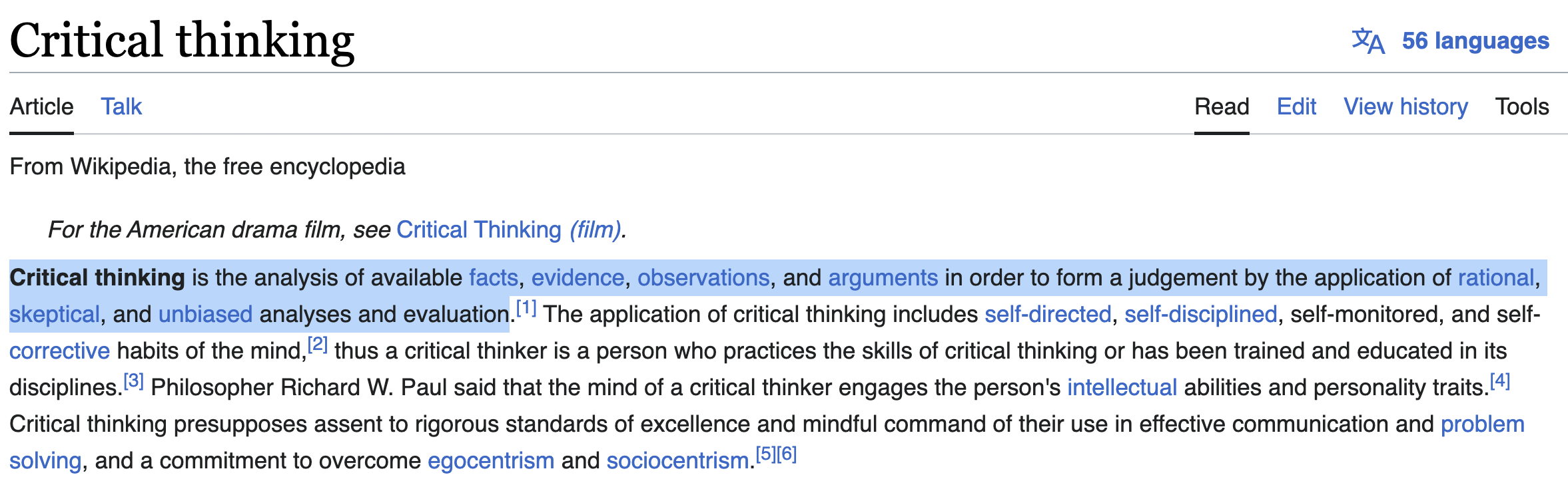

6. The original article could indeed “open other people’s eyes” but for some bizarre reason it has closed YOUR eyes, which is even more bizarre as you falsely claim the exact opposite?! The article explains why F5 is broken and why F1 is the best option but you’ve closed your eyes to all of that and chosen the broken one! To continue:
I believe people who have a second thought (or who apply their own critical thinking) would come up with a different answer with the help of the original article, i.e. How to pick the best filter setting for your DAC – Addicted To Audio
Exactly, with the help of that article and applying “their own critical thinking”, people would indeed come up with a different answer (to F5 appearing to be better solely from it’s Dirac impulse response) but even with the help of that article you have still not “come up with a different answer” so from your own words, you have NOT applied your own “critical thinking”!!
Why is this, why do you keep mentioning applying critical thinking but then do not apply it yourself? The most likely reason is either you are just trolling or you have a vested interest in promoting this false narrative/psuedo-science, although it *might* be that you are just very deluded. Eg. You falsely believe your are applying critical thinking, a good learning technique and have had your eyes opened but actually the opposite is true; you are not applying critical thinking, you apparently have no learning technique (let alone a good one) and your eyes are closed to the actual facts/science! That’s why you were censored on ASR and why you will have a rough time here as well, but I suspect you already know that!

Thanks for your reply. It looks to me you may have a differet defintion of "critical thinking". Based on wikipedia:
Are you talking the same thing here?
