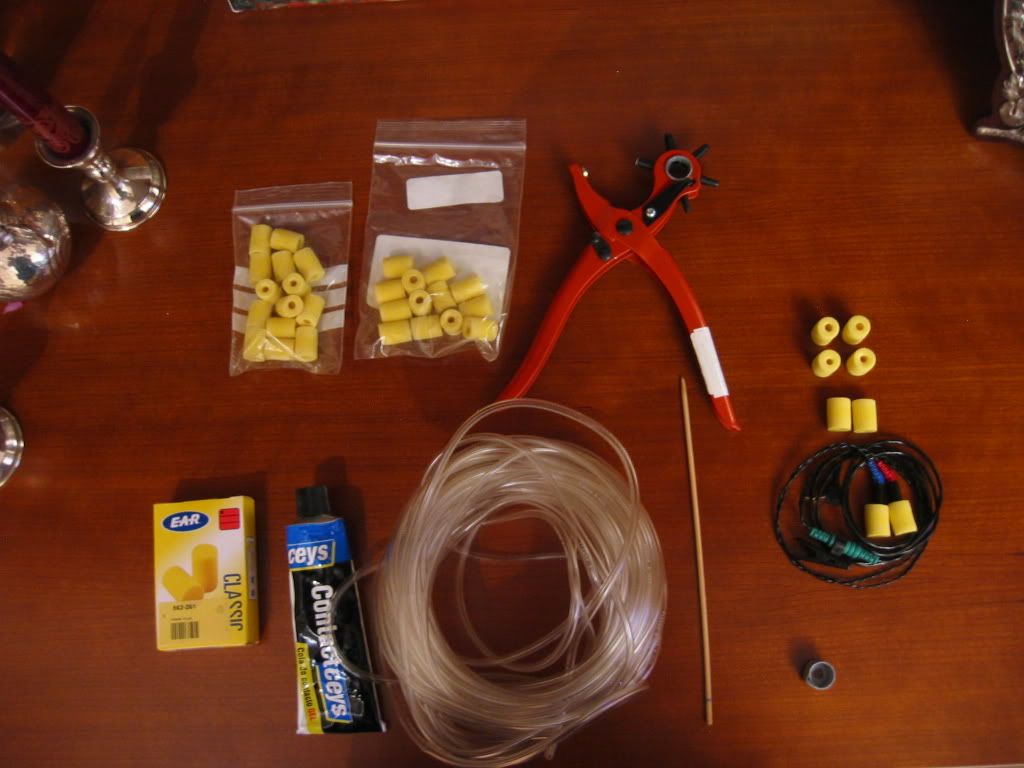

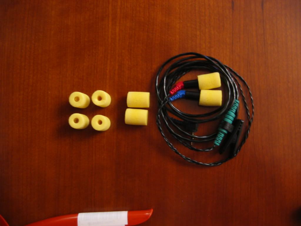

Result
Some photos so that you can decide if it is worth reading the whole post(long)
Photo1 Alternative Link
Photo2 Alternative Link
Photo3 Alternative Link
Photo4 Alternative Link
Photo5 Alternative Link

Materials/Tools:
See photo
Notes on Tips
EAR Classic tips are very similar in texture as the large Ety tips. Size
wize they are longer than all Etymotic tips and width is between the yellow
and the black tips. Length is no problem and width is perfect for me. For
other users they might be too big.
Isolation is similar to the best I had with yello Etymotic tips. Sound is
also excellent, no difference than the yellow Etymotic tips.

Contruction
Having a look at the tools the process is quite obvious. The only trick is
not to squeeze the tips completely (like a coin) because punching a hole
in that state deforms them permanently. I found that it is safer to squeeze
them half way, just to fit into the mold you see in the picture and and punch the hole.
This process is not perfect:
1. I ocasionally get a lightly deformed tip (just one of the edges). No big
deal.
2. I have to let them for a day in order to retain there original state.
3. If I enter it correctly on one side but don't calculate correctly the
projection of the punch on the other side, I get hole that is centered on
one end and off center on the other. No big deal. They work just the same.
4. I don't find it necessary to cut them in length so I don't do it. The
work fine as they are and cutting them perfectly with a sharp knife is
messy.
