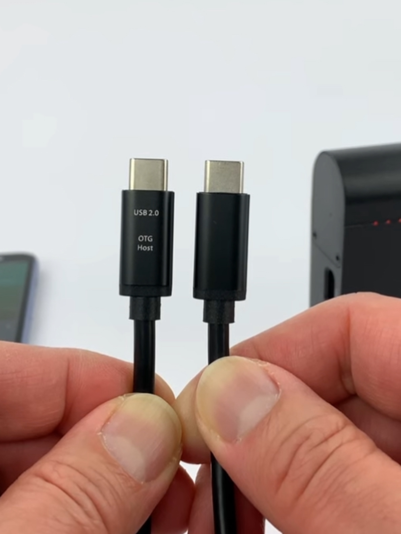

For the life of me, I don’t understand what I’m missing when trying to output, from the USB-C out, into another device. For instance, I’m trying to use the R4 as a streamer into a Woo Audio WA11 Topaz. The Topaz has an input USB-C, where I connect for anything else.
Any thoughts and/or ideas? I’ve tried using the supplied Hiby USB-C cable as well as another cable, I was advised to buy (inexpensive one on Amazon).
https://www.amazon.com/dp/B09YM3V7NX?ref=ppx_yo2ov_dt_b_fed_asin_title
Woo Audio webpage has a link to a “Learn More” video on how to connect the Topaz to various sources, including Android.
They clearly show a (supplied?) OTG cable:
Your Anker cable is not OTG as far as I can tell…
