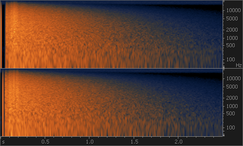

And there's this as a demonstration of what happens when you reduce the bit depth of an audio file.  Although I would agree you would have benefits during playback while using heavy DSP's, etc... would they be audible differences at the playback level?
