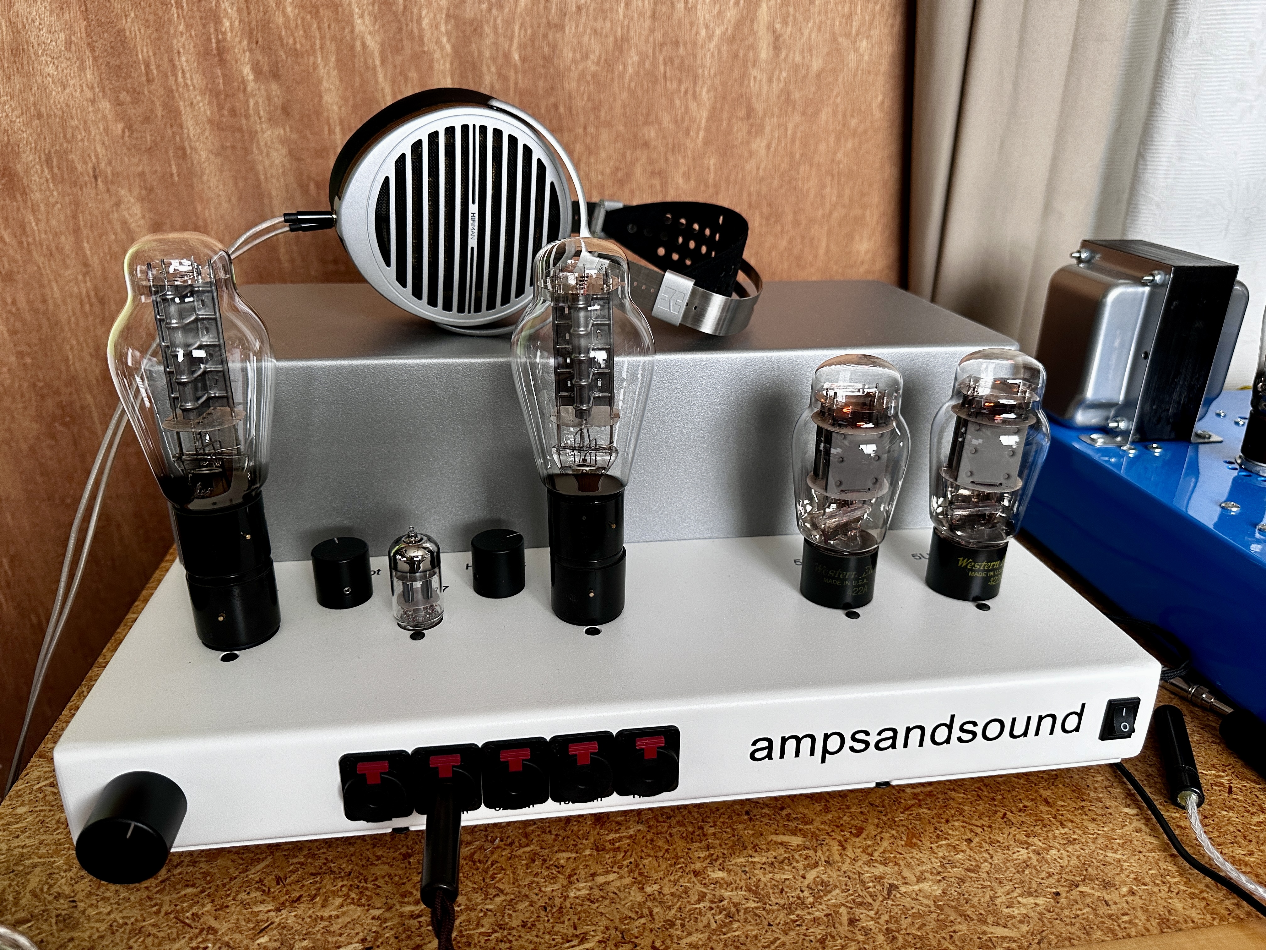

New (to me) Agartha 2021 owner checking in
Sep 20, 2023 at 3:48 PM Post #2,538 of 3,076
Niiice setup! Congrats
How do you like the ZMF Agartha combo?
How is the noise floor on the highZ output?
It’s an incredible combo
High Z was a bit noisy at first but a 12AU7 input (or equivalent) tames the noise
I’d suggest either a G73-R or an early 12BH7 (black plate) as an input. I’m loving my Tung-Sol 12BH7 black plate as an input with the Elrogs so much I have a UK Brimar and early CBS Hytron 12BH7 coming as well
I’m also running a GS-X MK2 as a preamp which helps add back some headroom from the lower gain input without raising the noise floor
Oh and I have a pair of new production WE 300Bs on the way to compare against the Elrogs
I bet it sounds awesome!
Fighting noise in my own A&S amp I have come to really appreciate the 6SU7GTY=6188 Tungsol round black plates coated glass.
It is simply the quietest 8-pin tube I have tried in the A&S.
But the 9-pin small tubes are also nice - and always very quiet.

I think I just made headway on my noise issue, it was my rectifier. Swapped the Fivre 6AX5GT for an early 1951 RCA 6AX5GT (Solid Black Plates - No Holes, Square Getter) Most of the noise is gone, and bass is a bit more articulated so I’m sticking with this rectifier for now.

Tonight’s roll, Melz 1579 & WE300B (incredibly lush, full bodied romantic sound). Melz 1579 are a perfect match with the WE 300B. This is one input tube that has better synergy with the WE than with the Elrogs.
