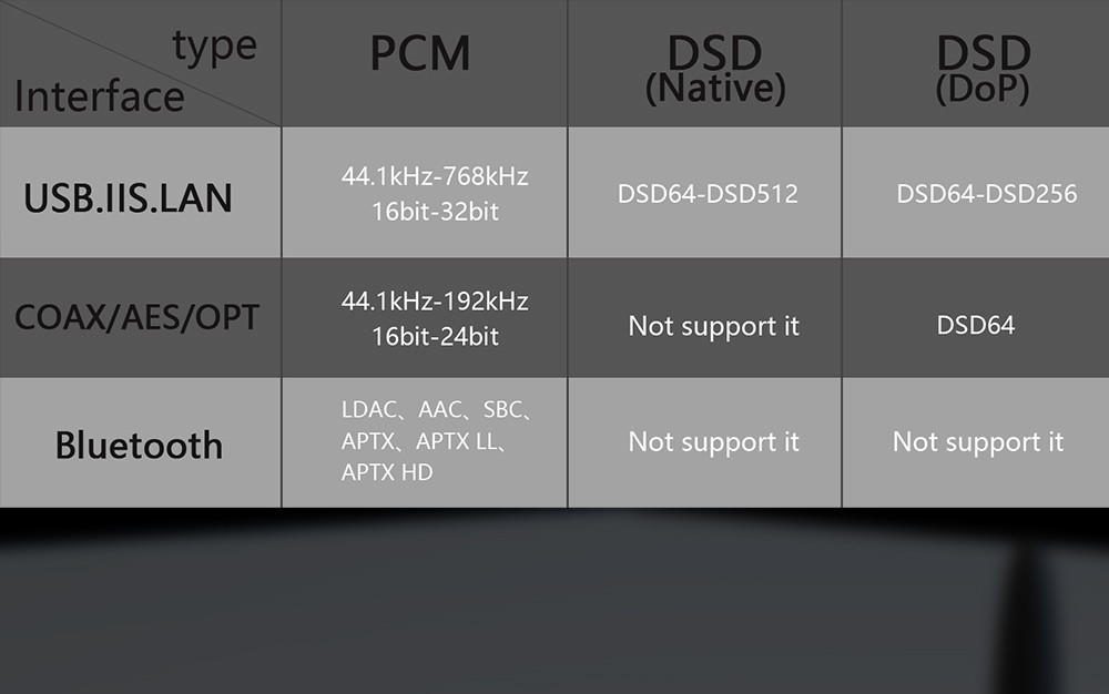

On Gustard's product page, it says it can support DSD512 but in Native mode via LAN.
aHR0cDovL3d3dy5ndXN0YXJkLmNuL3FmeS1jb250ZW50L3VwbG9hZHMvMjAyMi8wNi9iYTJjMmVkNWQ5N2JkYWQ5YjZlYzczMjBjZWQ4ODczNS5qcGc_p_p100_p_3D.m.jpg
R26 maybe ROON ready but NOT certified. On the renderer options/settings you can't set DSD to Native, ONLY in DoP. Hence upto DSD256 only. Just speculating. But I think this is the case. Maybe same too with other protocols (UPnP)? Only in DoP?
Not sure if your firmware isn't updated, but I can set R26 LAN endpoint in Roon, to native DSD.
That is how I was playing DSD.
And yes, the R26 did play DSD512 from LAN, but as I mentioned, it starts breaking up after awhile. Like the R26 doesn't have enough processing power or something to handle it, or the buffer is too short. Could have been that specific DSD512 track, not sure.
