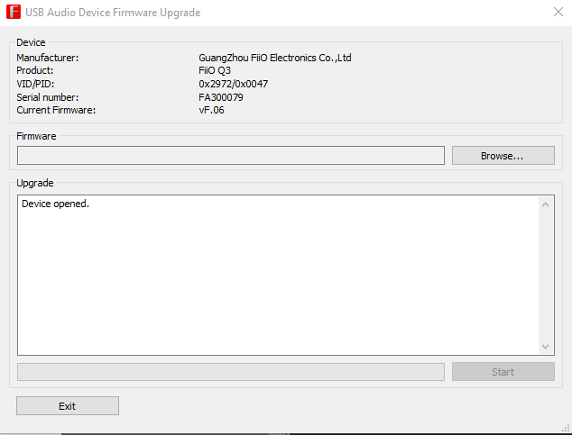

My FiiO Q3 has been disconnecting/reconnecting for a while now, but it's become worse lately. I've tried to install the FiiO Control Panel but it somehow seems to make the problem worse when it's launched. I've tried testing multiple devices, multiple cables. Still, the Q3 becomes undetectable at some weird moments.
Apparently my firmware is vF.06 as you can see on the screenshot. Could I please have a link to try and install a newer one ? I'd like to test and see whether it resolves this issue. Thank you !

Dear friend,
You don't need to update the firmware. Does the disconnection happen when charging the Q3 as well via different cable? If yes, it seems that the issue is located in the USB port of your Q3.
