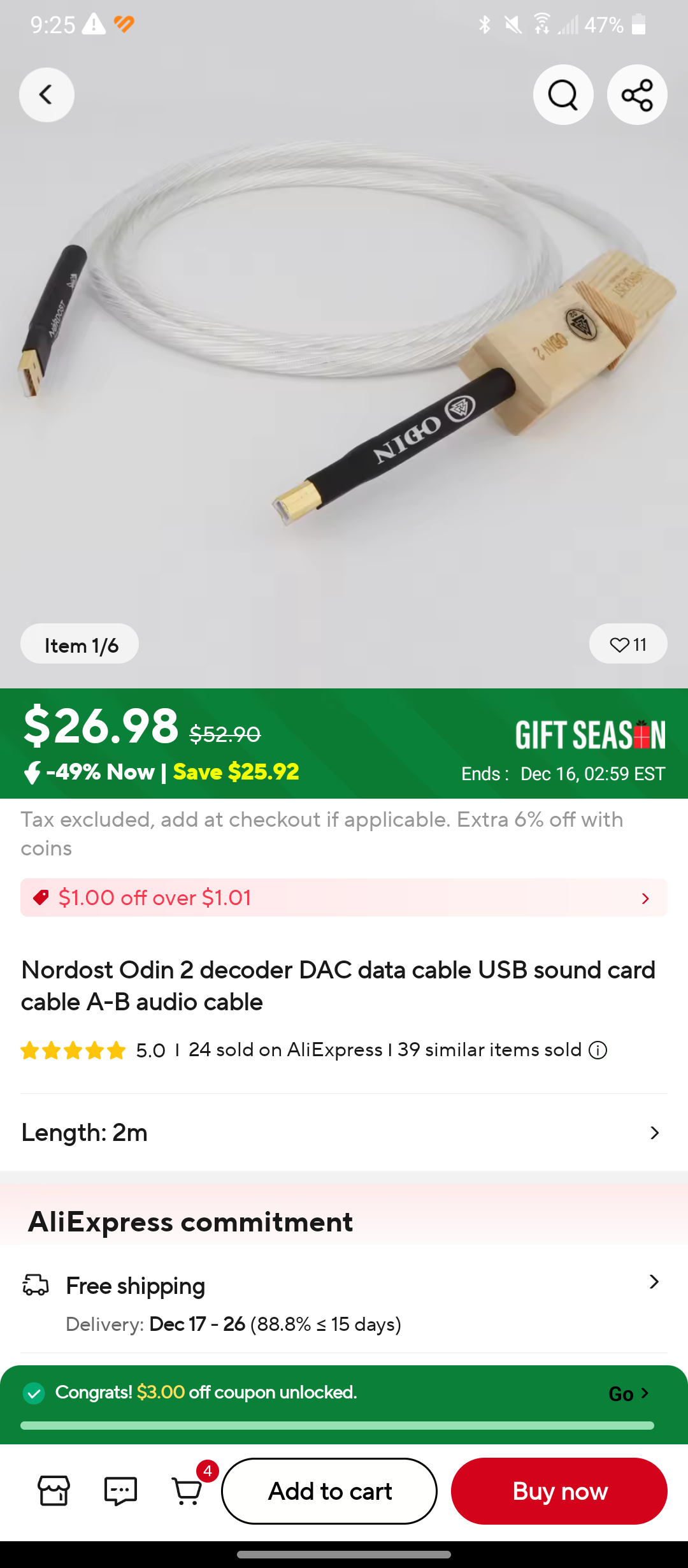

Do you mean the usb cable? From personal experience, I would say this is worth upgrading. No need to spend a ton of money... the Odin 2 USB knock-off cable from AliExpress is what I use, and is roughly $25 USD depending on length.
-I dont think there is an official store in aliexpress for this specific cable (Odin 2) knock off, if you can provide me with a link I'd appreciate it (for 3m long) 10ft long
This is moonsaudio store. The cables are drop shipped from warehouses so as long as it looks like this, they're the same cable sold by different stores. Just find the cheapest in your country. Check the homepage of AliExpress and the store home for coupons.

But for Now, I have ordered both the balanced cable from (Openheart), and a USB A to USB B Nordost Odin from (MoonsAudio) 3 meters. it should be more than enough.

Both arrived, The Balanced cable and The Odin cable.
First Odin Cable is damaged, I think,
because when I connect it to my dac and play any sound for any headset i have, there is a sudden electrical pulse that is irritating and very loud. so I will return it

Glad the balanced cable helped! For the Odin usb, plug it in directly to the laptop, not the Anker hub. And don't run it over the top of the laptop. Still same issue?
Dec 21, 2024 at 11:28 AM Post #12 of 15
It doesnt get recognized by the laptop if i connect it directly, and i did connect it to the desktop , the only usb attached to the desktop is the odin cable, and the cable was on the carpet. Still same issue
Dec 21, 2024 at 11:41 AM Post #13 of 15
That's a strange one. Even after a restart with the cable connected during boot?
Dec 21, 2024 at 11:52 AM Post #14 of 15
The cable is not consistant and weird, I bought the anker hub for extra Usb 3s thinking that the one on my laptop is a Usb 2, but it turns out its a full usb 3 ... now the hub is connected to a thunderbolt 4, with usb 3 speeds up to 5GB, it worked fine with the hub.
As for the desktop, i have both usb 2 and 3 near eachother and same thing , on usb 2 didnt recognize it on 3 it did immediately.
Keep in mind, i removed everything from the desktop all accessories and still got the electrical sound,
On the laptop however, when it got recognized the pulse sound (i dont know which terminology i should use) it became louder, thats why i wanted to capture the video very fast so i dont damage the edition xs.
Dec 21, 2024 at 11:53 AM Post #15 of 15
I'm not sure what's up but yes, I'd return that cable.
