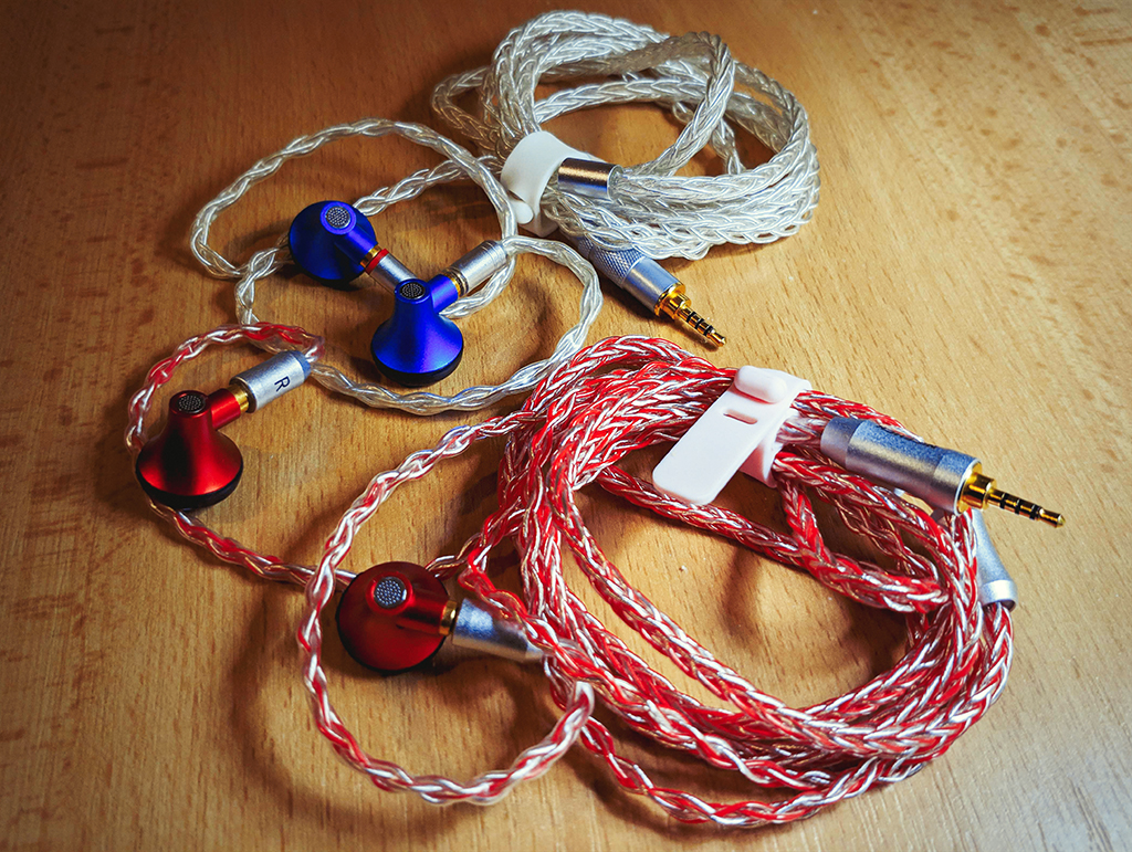

Here's an interesting one... You'd think that the EQ changes on this bud would sound really different from stock tuning -- not really the case. The changes are subtle and not very pronounced.
I play with some new buds that I bought last week and today I bought a spare pair. I just test to see if there some changes after the >40h break-in period between these two.
I will post more info in a few days about this interesting "retro" model with great tonal balance.
