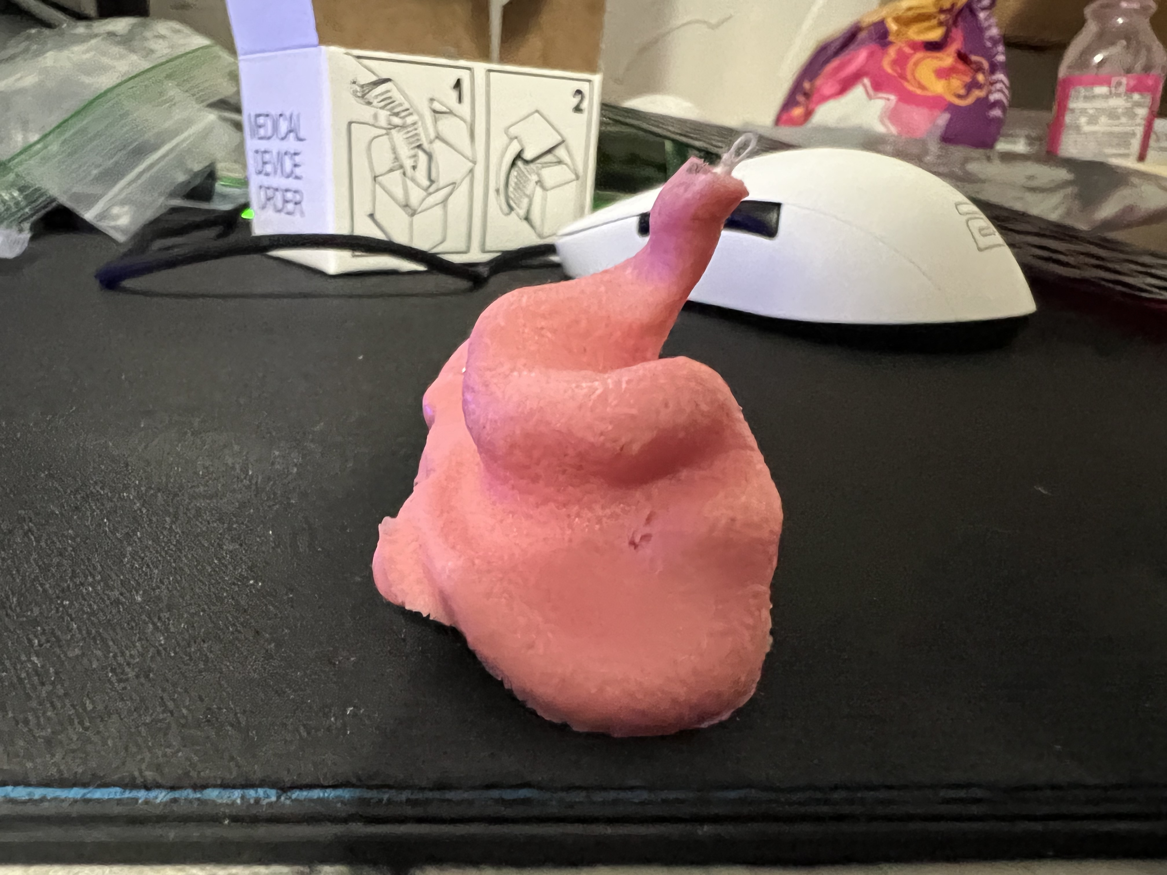

I just got my impressions done for the JH13s I'm about to purchase. However, I'm a little worried that he didn't do them right... I gave him JH Audio's instruction sheet, but he didn't use cotton (or foam) and he didn't use a bite-block. I kept my jaw open and tried not to move, but after ~3 minutes of the goop in my ears, he specifically instructed me to close and open the jaw.
I asked him why he didn't use a bite block and he said that if I had been a "rock star", he would have, but since I'm using them only for listening, it's not a big deal. He said it's mainly for comfort when the jaw is open, which happens when you're singing but not when listening.
So, I'm worried that the impressions aren't deep enough (given the lack of cotton usage) and that I won't get the right seal (because of the jaw). How worried should I be that these impressions will result in ill-fitting JH13s? Will JH Audio be able to tell me if the impressions look improper?
Yours look great. Mine turned out rather rough. The place charged $200 for the impressions and they look worse than I expected. Lots of little holes. Even gave them the paper of what 64audio wanted.
