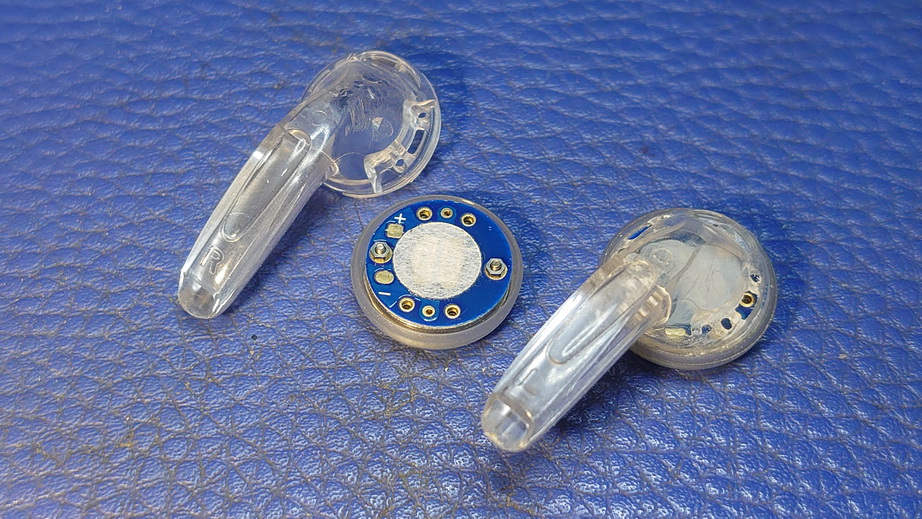

It has been almost 2 year ago that I challenged myself to fit a planar magnetic transducer into an earbud shell. The result, while good, can only be considered as 75% successful because of fit and sound. After all these time, I thought it is time to give it another go - with the same $120 planar magnetic transducer sourced from Aliexpress, but with a more ear-friendly shell - a MX500 type shell to be exact.
Parts Requirement:
1) 14.2mm planar magnetic driver x2
2) Transparent MX500 shell
3) Small rotary tool, i,e,. Dremel and small and small sanding bits
4) Normal soldering supply
5) Glue. In this case, the E8000, UV cured glue as well as thin 3M double sided tape.
As you can see, the 14.2mm transducer can fit into the front plate of the MX500 shell (*typically housing 15.6mm transducer) without any issue, but the back chamber will required heavy modification. Basically, all the side vents of the back chamber need to be sealed off with UV glue, then all the extra bit of plastic surrounding the back vents need to be sanded off until the planar magnetic transducer can fit completely inside with the front plate closed. While difficult, it is not impossible - though do be careful not to over-sand and penetrate the wall of the shell.
Lastly, the back vent of the shell is opened up (*many MX500 shell has a vent structure in the back but it is actually fully closed) to replaced the closed side vent. MMCX socket is fitted and soldered to the transducer. The transducer's side is fitted with double-sided tape to secured it into the back chamber, then the front plated is glued to the shell with E8000. Before the transducer is sealed in, the paper filter on the back of the transducer is moved to the front of the transducer to act as dampening filter / tuning.
Afterthought: As it stands, I'll call this a 90% success. First, fit has been dramatically improved from the wooden shell I used before. The new version required less critical fit to get a good sound out - which means I can use it more like a regular MX500 style earbuds which looser fit doesn't affecting SQ. Secondly, SQ has also improved as the new tuning has a more forgiving and relaxing sound than the old tuning. On its own, It is still a bit on the thin and bright side of presentation. With a bit of bass boost using EQ however, it sound rather balanced and neutral - definitely not something for bass-head, but otherwise a second to top-tier contender. The reason I called this a 90% success is because it does need the bass EQ to sound great, and I felt that I have pushed this particular transducer to its limit as far as an earbuds' transducer goes. To really address its weakness in bass, it will either be re-tuned as a driver or have a dedicated 2nd dynamic bass driver for a hybrid configuration.
Parts Requirement:
Lastly, the back vent of the shell is opened up (*many MX500 shell has a vent structure in the back but it is actually fully closed) to replaced the closed side vent. MMCX socket is fitted and soldered to the transducer. The transducer's side is fitted with double-sided tape to secured it into the back chaember, then the front plated is glued to the shell with E8000. Before the transducer is sealed in, the paper filter on the back of the transducer is moved to the front of the transducer to act as dampening filter / tuning.
Afterthought: As it stands, I'll call this a 90% success. First, fit has been dramatically improved from the wooden shell I used before. The new irritation required less critical fit to get a good sound out - which means I can use it more like a regular MX500 style earbuds which looser fit doesn't affecting SQ. Secondly, SQ has also improved as the new tuning has a more forgiving and relaxing sound than the old tuning. On its own, It is still a bit on the thin and bright side of presentation. With a bit of bass boost using EQ however, it sound rather balanced and neutral - definitely not something for bass-head, but otherwise a second to top-tier contender. The reason I called this a 90% success is because it does need the bass EQ to sound great, and I felt that I have pushed this particular transducer to its limit as far as an earbuds' transducer goes. To really address its weakness in bass, it will either be re-tuned as a driver or have a dedicated 2nd dynamic bass driver for a hybrid configuration.
