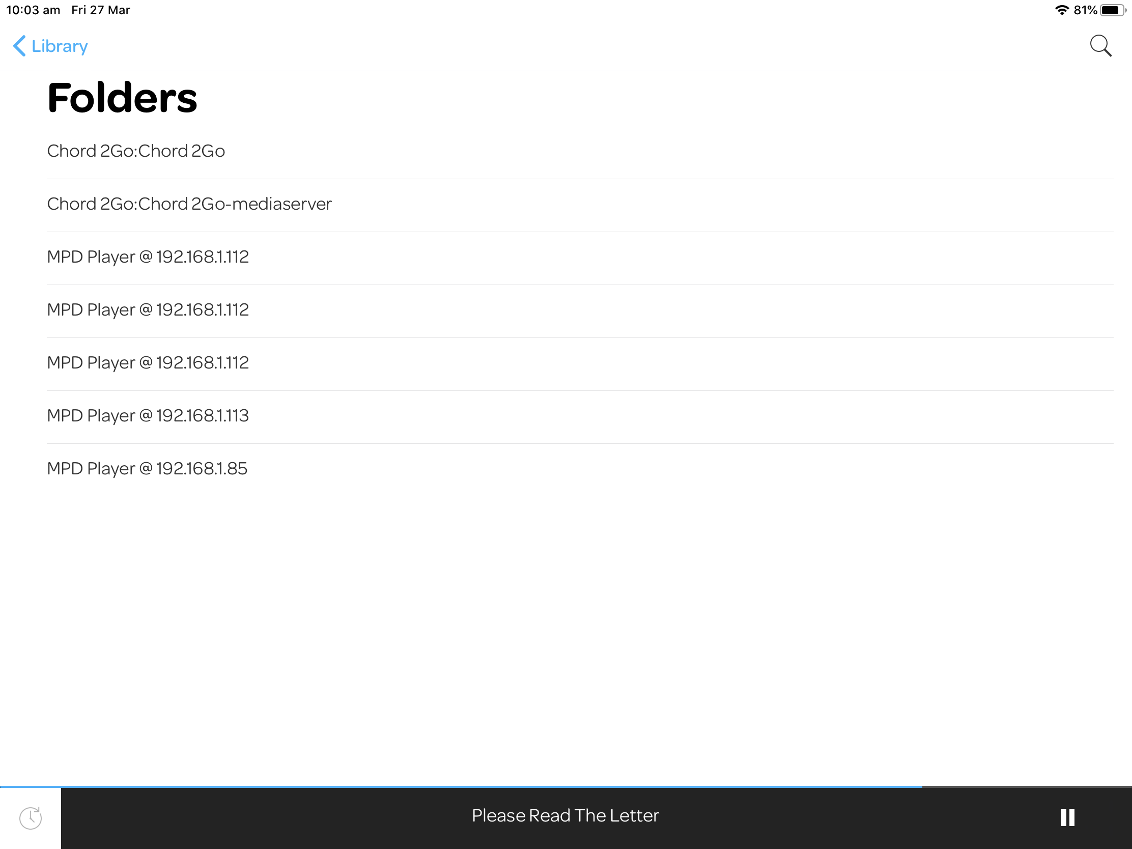

Is there an explanation anywhere of how playback from SD card works because I am getting a bit confused.
I am using Glider as a control app and 2Go shows up several times as different source devices. Whichever I choose, playback seems dependant upon a connection with my iPhone and the volume on Hugo2 can be controlled by the phone which makes me suspect that I am streaming from the SD card rather than playing directly from the card into H2. Having said that, playing music from the card does sound better than playing through Roon, which is streaming, so maybe I am wrong.
If anyone can point me to a source or explain how I can definitely tell that I am playing from the card directly, that would be very much appreciated. The instruction manual seems very vague on this.
Mar 27, 2020 at 11:35 AM Post #863 of 6,477
This may help explain my confusion. All references to MPD are 2Go related:
Mar 27, 2020 at 11:44 AM Post #865 of 6,477

Glider app seems to not be supported for some time. And even with mojopoly this issue was happening. Check maybe Rigelian app as well. But if it plays it plays rather then stream. Check if you see the played track in go figure. If you will see it there and will be able to start stop playback using go figure within current folder it means it shall be fine...
Thank you. I tried Glider with MojoPoly a year or so back and gave up in the end and went back to my AK player. I‘ll check out Rigellian.:thumbsup:
Mar 27, 2020 at 12:14 PM Post #868 of 6,477
Yes sadly Glider has not been updated for some time now and we are no longer in touch with the developer. It really needs updating to be fully compatible with both Poly and 2Go now so you may get some strange results. Rigellian has been getting some very good feedback on the Poly thread so give it a go.
